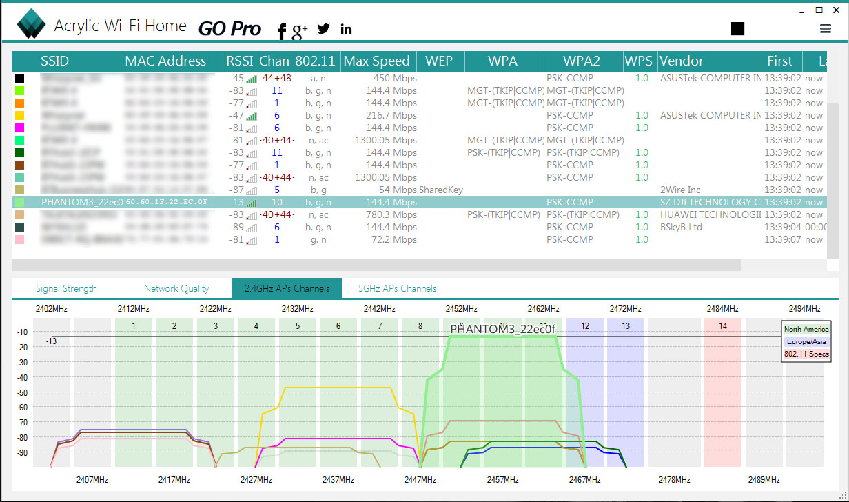

    Screen dump from Acrylic WiFi after applying the Icarus patch....this is in the house, with all the local wifi networks, and you can see it overpowers my home network too (yellow trace on channel 6) :)
    jeganx likes this.
  13. WilliamM
    May 30, 2016
    1,751
    481
    Lancaster, Pa.
    What setting do you use above for the RC ?
  14. Andy_R
    Oct 1, 2016
    24
    9
    The same - 27dbm - but it won't have any effect for you, as you're already in FCC mode. This app is really aimed at CE locations
