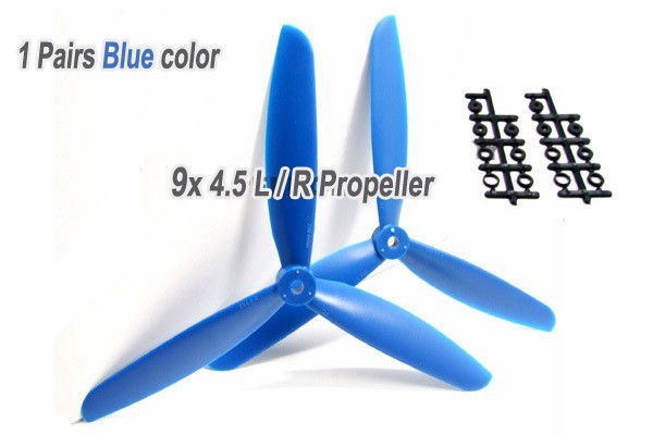

    @Martcerv had said most of the same procedure I did with the Tri GWS 9050 and the Blue Tri-blades 9045.
    I agree with no sanding. Be sure to lock in the correct way the DuBro cones to the right side of the prop (plain side of the cone must be on bigger hole side in prop)
    I use long - thin tape stripes instead smaller -wide. Better a long stripe and you will cut small pieces until get balanced, then do a tight stick of tape to the prop. When 3 wings are balanced but stil rotate on DuBro balancer, I applied nail paint over the central nut opposite to the side that moves down and use a bit of hairdryer to dry faster, then turn prop until it get stable in any position.
    [​IMG]
    I use mine with White Antigravity T-Motors, but tested before with stock motors also. My phantom is 1200 AUW, so the tri-blades lift easily on my 2600 mts ASL (very thin air here) so I get shorter flight times but compensation is the great power with the GWS Tri-blades.
    The Blue tri-blades put 2 "horse power" on phantom when you throttle up :lol:
    I use a GPS Data Logger (iGot-U) and with stock props meassured 3 mts x sec climb up full throttle. With those blues got 7.4 mts x sec :eek:
    My 2700 mAh batteries went out of power (first alert level) after 7-8 minutes with blue Tri-blades 9045 and around 11 minutes with black GWS Tri-blades 9050 :mrgreen:
