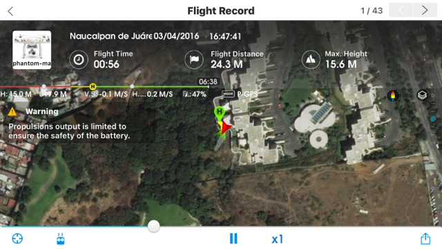

    I have same warning message but when have 47% of battery

    I have had that message a few times this winter. Even with battery at 95-100%. It only appears when I fly with the temp below about 40 degrees F.

    Did you not read the above posts? Which part is unclear?
