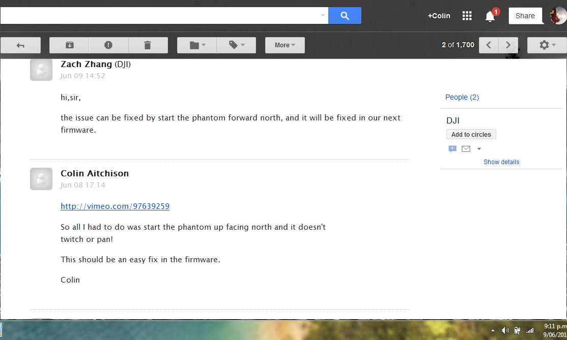

  19. Captain Salty
    May 28, 2014
    53
    Just got this email/echo back from DJI. Good to know a fix is inbound.
