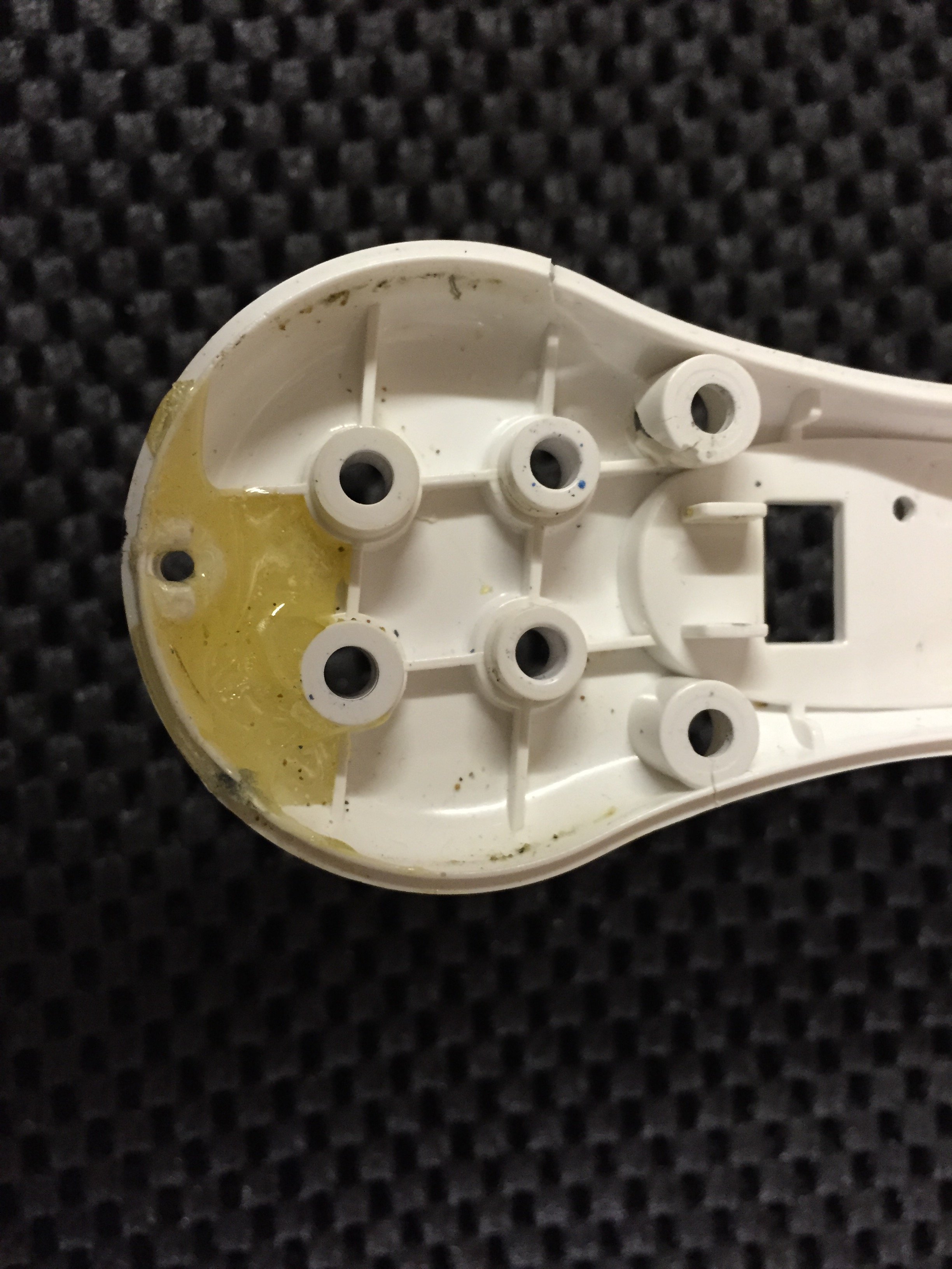

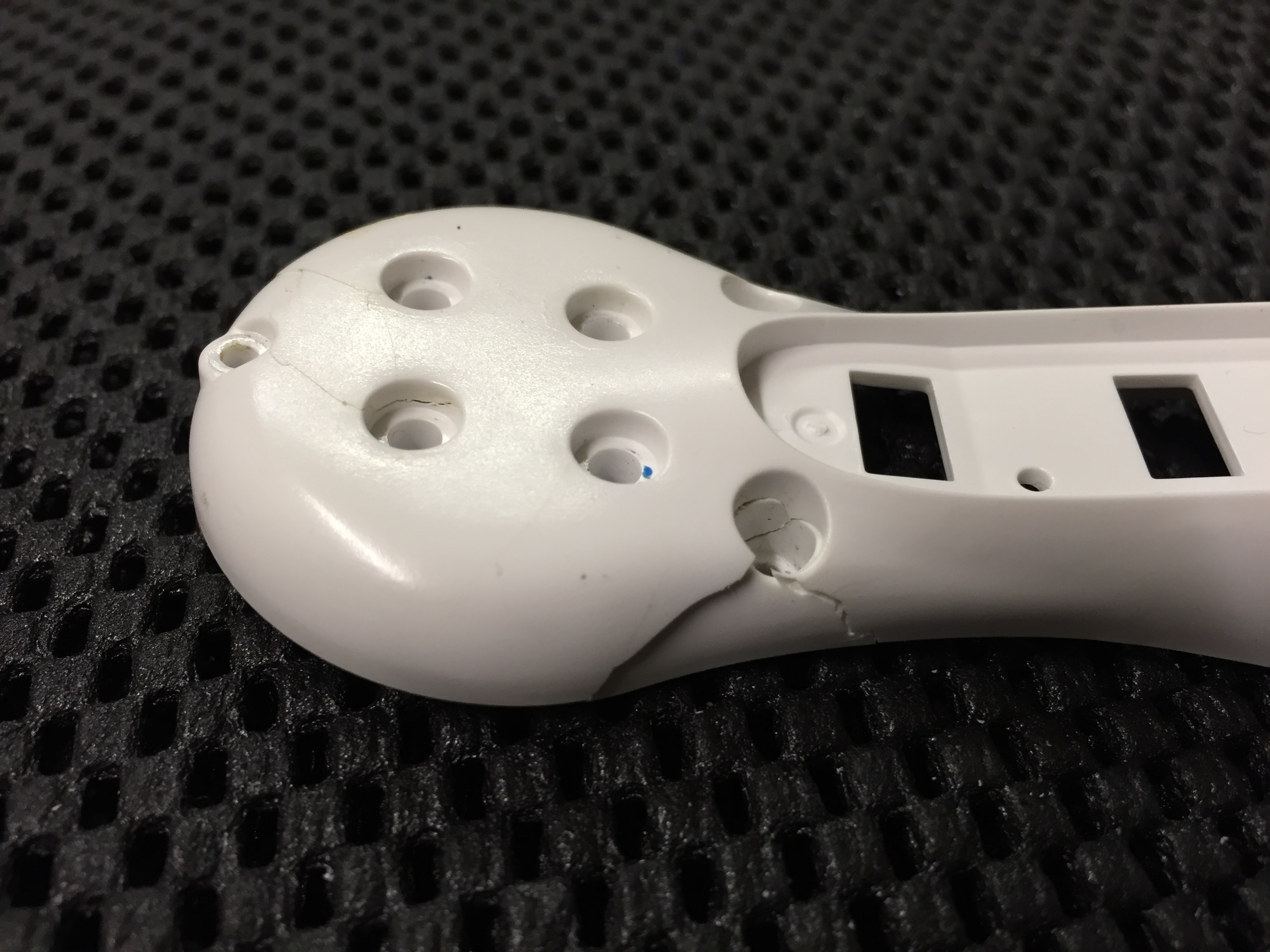

    I found also that the previous owner had tried to repair the cracked shell with epoxy glue, see pics below.

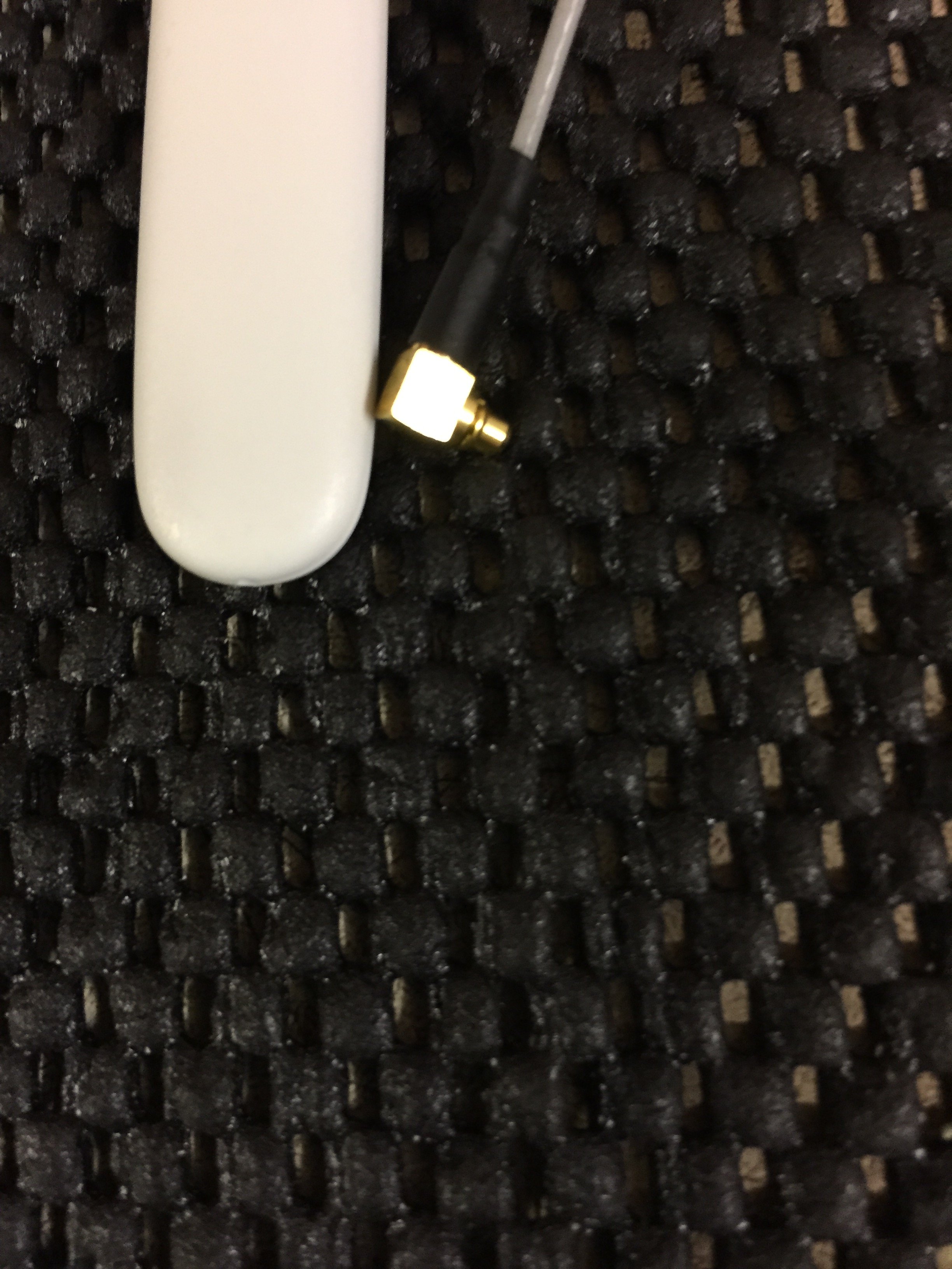

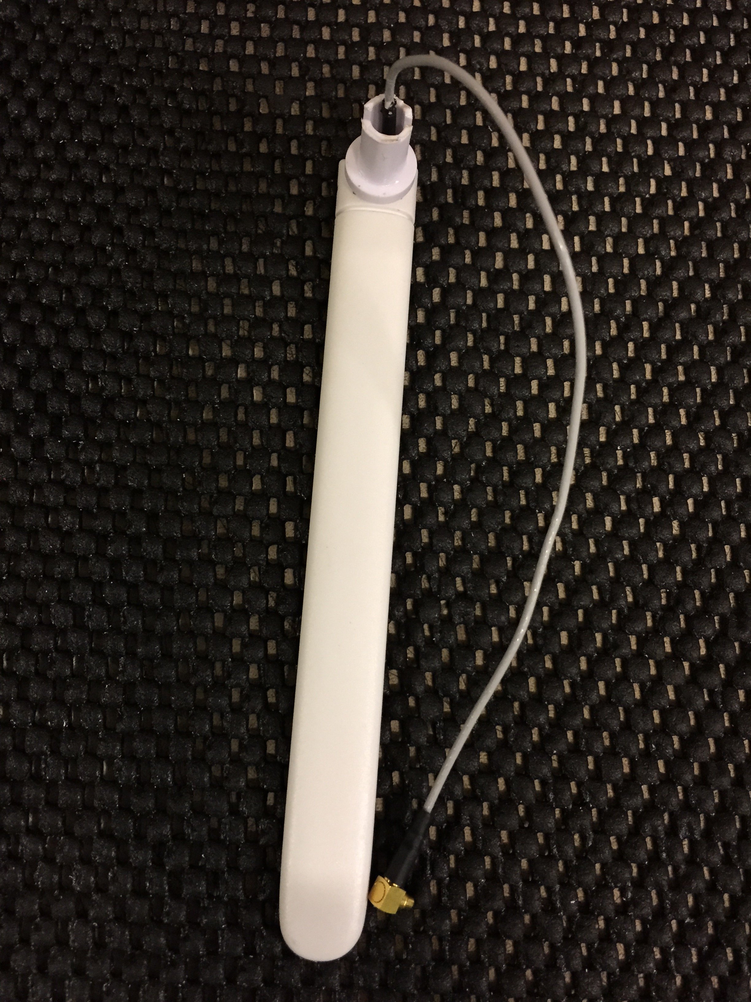

    I got two of these bud, I am not sure if they will be long enough on the cable lenght though and lso if the connectors are the right size..
  16. dirkclod
    dirkclod Moderator
    Staff Member
    May 9, 2014
    12,841
    6,874
    Amory Mississippi
    Wrong connecters Flack but they will need to be something that's 2.4 .
    Those almost look like the antennas for your Pro TX
