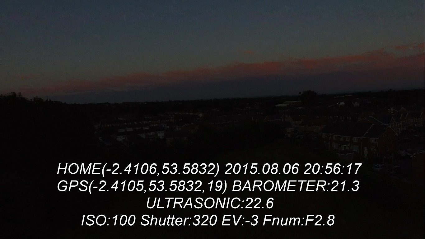

    Hi everybody!
    Just tested new firmware 1.3.20
    Hoping no issues this time...
    The flight itself was perfect - rock solid while in hover,only one moment lost connection for couple seconds
    when the bird was right above me just 70 m,never happened before...
    Made a few flights spent two batteries -no issues flies perfect.
    As soon as I checked the video was surprised to see the telemetry tags on the screen.
    anyone knows what to f////k is that
    upload_2015-8-7_3-51-0.png l
    Thinking to use the new fiture - downgrade to 1.2.6 and probably reinstall ???

  16. Inja
    Jul 30, 2015
    Relax - those data are just a subtitle-file placed into the same directory. Simply delete them or right-click on the screen an chosse not to display them.

  18. bbfpv
    Feb 3, 2015
    3,857
    1,146
    Long Island, NY
    Disable captions in the app...
  19. 3pa4ok
    Aug 6, 2015
    25
    4
    Everyone knows what's wrong and what to do
    but could you ,please show me step by step
    How??>???> to do that
  20. Bronson
    Jul 8, 2015
    17
    in DJI GO app > tap camera setting ( right side of the screen) > there you find the "video caption" > slide the sw off.
