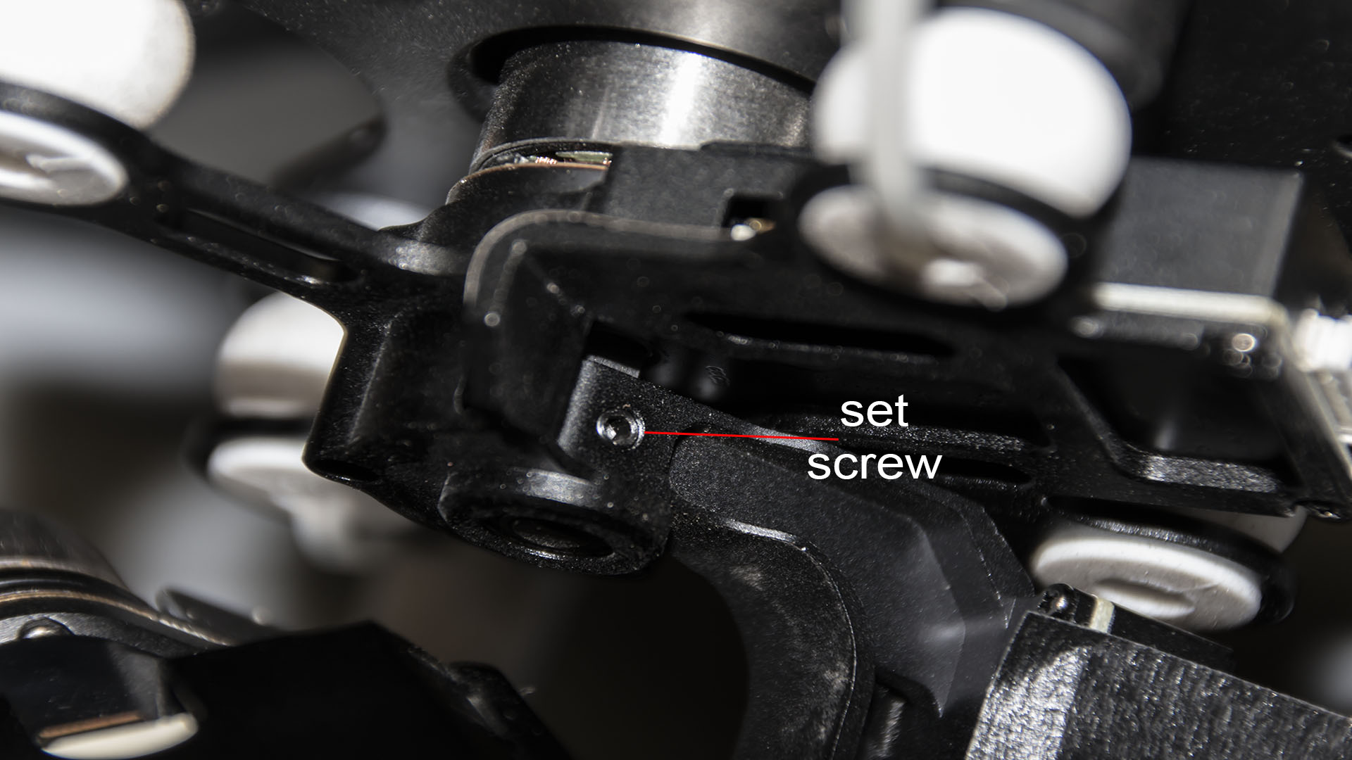

    There is a screw on the shaft under the yaw motor as in this photo make sure it's tight.
    Dose the camera stay where you last adjust it or return to the position as in you video.

    great now goes . but now there is a problem in the movement of gopro .
    Here's the video
  8. Alessandro
    Jul 7, 2016
    6
    I resolved, I had to calibrate x1 . Thank you very much!! You were great !!
