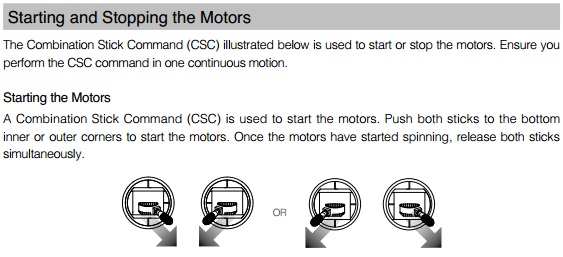

I just purchased the P3 standard.. I downloaded firmware,calibrated everything, camera is on showing a clear picture,GPS working..the remote moves the camera..but when I move the sticks to start the motors I get nothing..did I miss something?
Yes and I tried moving them outward not responding at allAre you moving both sticks down and inwards
Don't we allThis is why I read these threads. I learn something every day.
If interested, you can remove the throttle lock like this.The controller (RC) has a detente on the left stick that locks it to the rear if pulled all the way back.
Skip going down and move the sticks straight to the bottom inside or outside corners.Pulling down and in or down and out still locks the throttle in the off position and thereby not letting the motors start.
