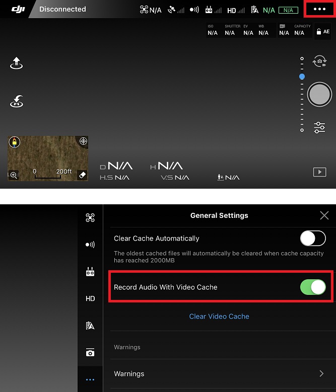

You are right.Because there is no "Record Audio With Video Cache" in my menu.There is a setting in DJI GO that'll allow you to record your voice with the video cached on your mobile device. You can find that setting here:
Note: This setting is not available for the P4P+ yet.
