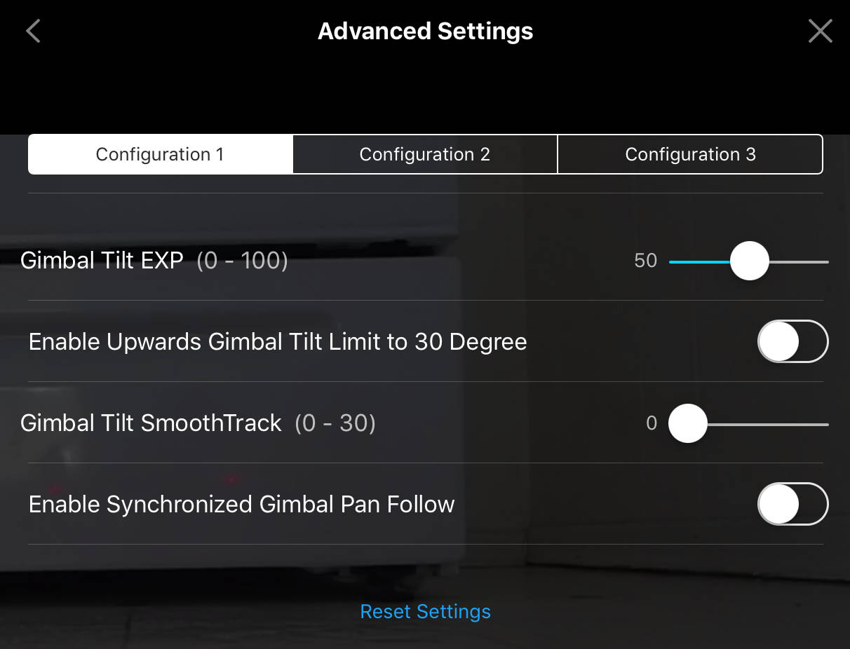

    What does everyone having the problem, have set for their Gimbal Advanced Settings? These are my new settings to try.
    I previously had:
    Gimbal Tilt SmoothTrack set to 0 and
    Enable Synchronized Gimbal Pan Follow set to OFF
  14. jwt873

    Here are my current settings.. It should be the default. I've never modified anything in the Gimbal options.

    I ended up modifying my remote as my P2 with a switch and 20 ohm pot on the yaw output, it was the only way I could get the extreme slow and smooth yaw. The stick internal pots could be a lot better. Litchi does help with smooth yaw turns, but I keep the tilt on manual, and have the Tilt SmoothTrack set at 21 for smooth tilts with out sudden stop at end of travel. Tilt Exp is at 50 also, Synch Pan Follow should be "on".

    Thanks for the input. The twitch is actually in the opposite direction of the intended adjustment, so reducing the output doesn't help. I'll try your settings! I'm hoping it's just the Synch Pan Follow that I had "off".

    Great! It's helpful to know the default values, without losing one's own by resetting them, and perhaps resetting something else inadvertently!
