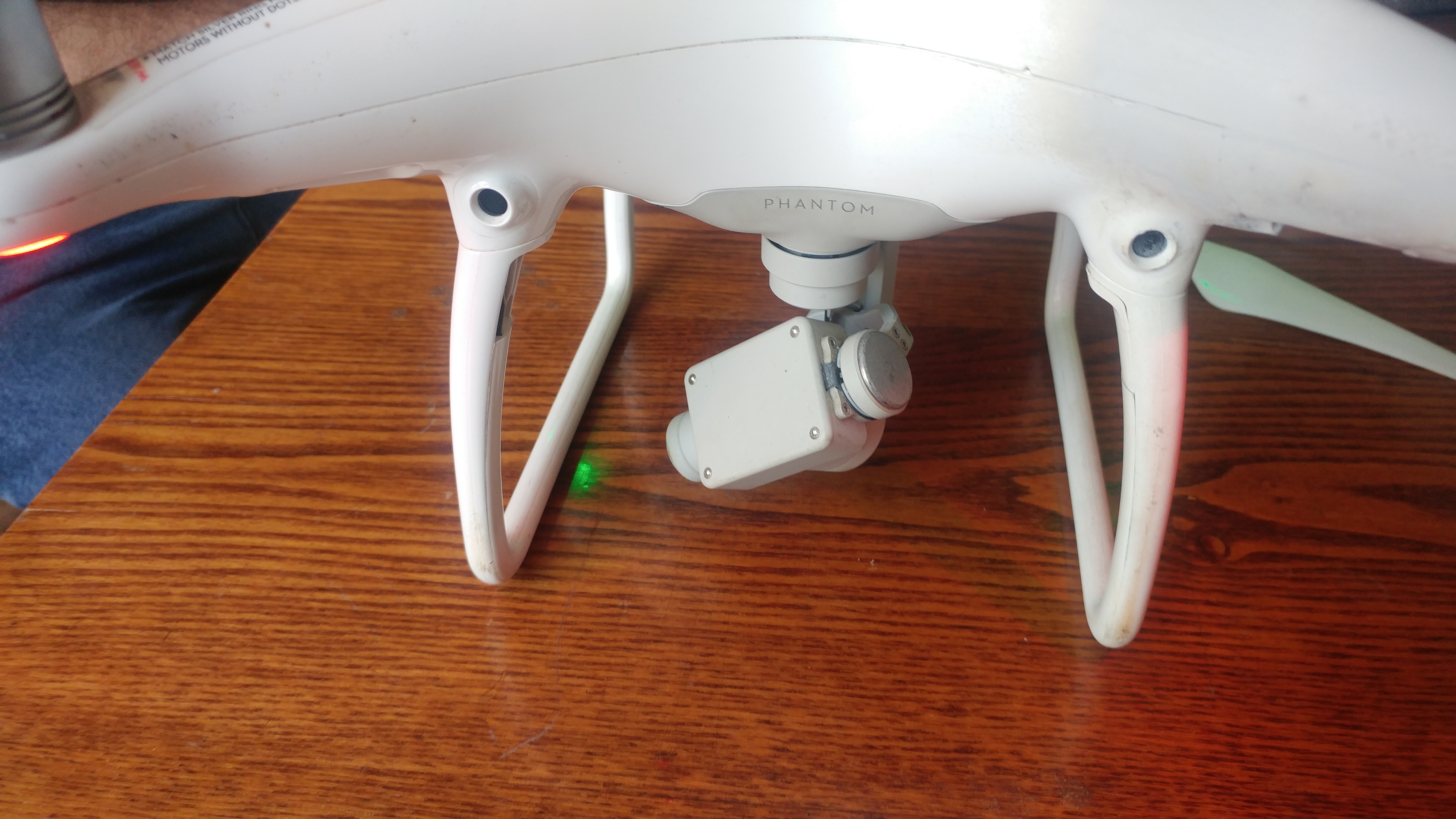

Hello i bought used phantom 4 seller never said gimbal was not working, any ideas??? firmware or hardware problem ?also which parts do i need to replace
Yes it was great deal only $275 on ebay body is damaged scratches etc.. i know how to replace the shell but seller never said camera was broken , i think it's gimbal esc however parts for Dji drones are really expensiveHi,
Can't really tell what could be wrong from that video. Could be ribbon cable, control board, motors. However what is apparent from the video is that the P4P has been through some rough times. The gimbal, landing gear, and body all show signs of wear, contact with something, or a crash. If those issues were not made clear prior to sale, then I would try to return it. Did you see all those scuff marks and scratches in the pictures prior to purchase?
I hope you got a really incredible deal on it because it seems that there is some repair work needed. My rule of thumb is always buy in person or in rare cases from a well-known and respected member of the forums.
Well yes it is cheap at $275 but not so much if you need to start buying multiple parts. ESC boards are not too bad but it gets expensive if you need to replace the camera/gimbal assembly.Yes it was great deal only $275 on ebay body is damaged scratches etc.. i know how to replace the shell but seller never said camera was broken , i think it's gimbal esc however parts for Dji drones are really expensive
fixed the problem! bearing on roll motor was pushed down took 15min and gimbal works perfectly !!Well yes it is cheap at $275 but not so much if you need to start buying multiple parts. ESC boards are not too bad but it gets expensive if you need to replace the camera/gimbal assembly.
That's great news. Enjoy the P4 !!fixed the problem! bearing on roll motor was pushed down took 15min and gimbal works perfectly !!
