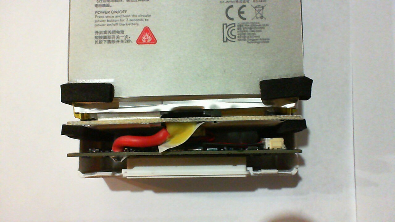

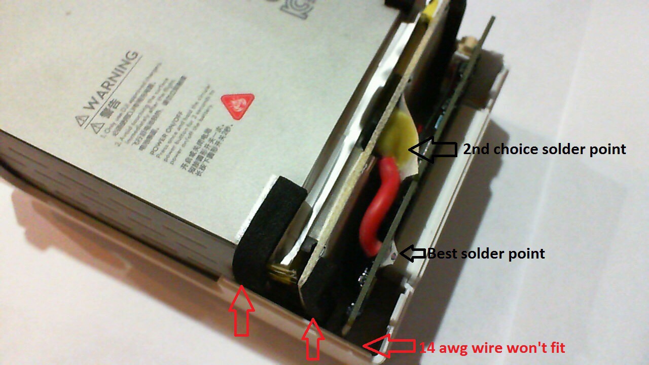

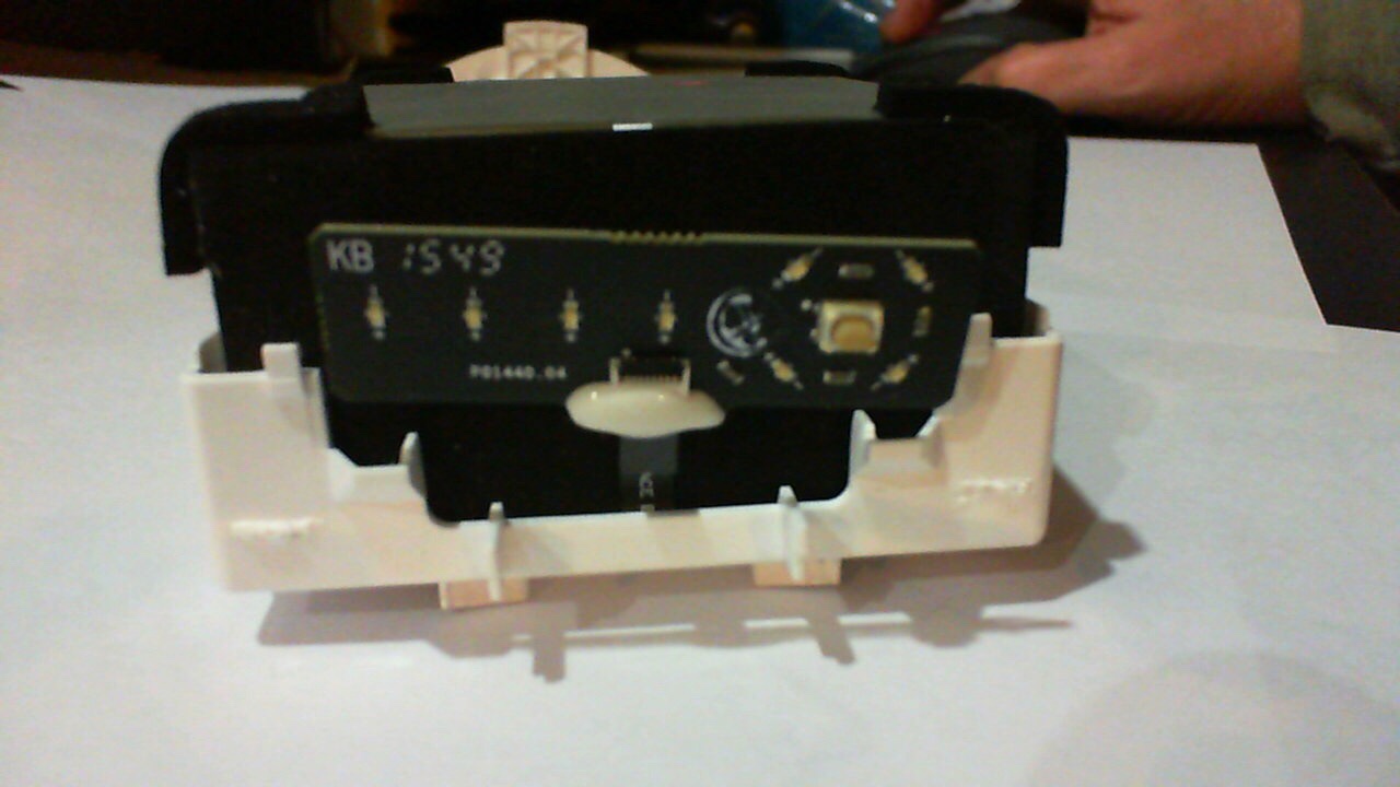

    ImageUploadedByPhantomPilots1466166961.050098.jpg ImageUploadedByPhantomPilots1466166985.631761.jpg ImageUploadedByPhantomPilots1466167024.184562.jpg
    Nope not hollow, just appears that way. Thats why modding the p4 bat for externals is almost unheard of because its so tight in there you dont have room to run even a 16 guage wire up the sides
  15. Sim597
    Mar 5, 2016
    1,040
    279
    What is this showing? Do u know bum? I can't tell if it's looking for a spot to connect too, or problem areas?
  16. Stealthmatt
    Jun 22, 2013
    381
    141
    I believe this is showing thoughts/instructions on how to solder an additional wire so you can get 2 batteries together for longer flight time.
