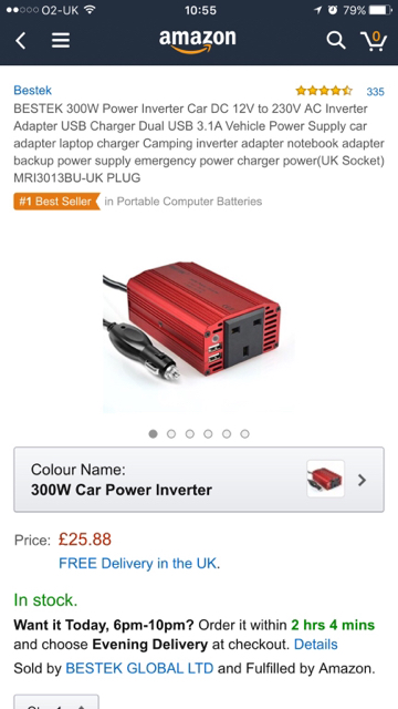

  9. realsting
    Dec 18, 2015
    311
    54
    LONDON, UK
    Thank you maseman88. I've not used inverters before, I saw this one:
    Would that do the trick without damaging my batteries?
  10. Stealthmatt
    Jun 22, 2013
    381
    141
    Yep that would do the trick - most have safety features built in to stop it draining the battery fully.
