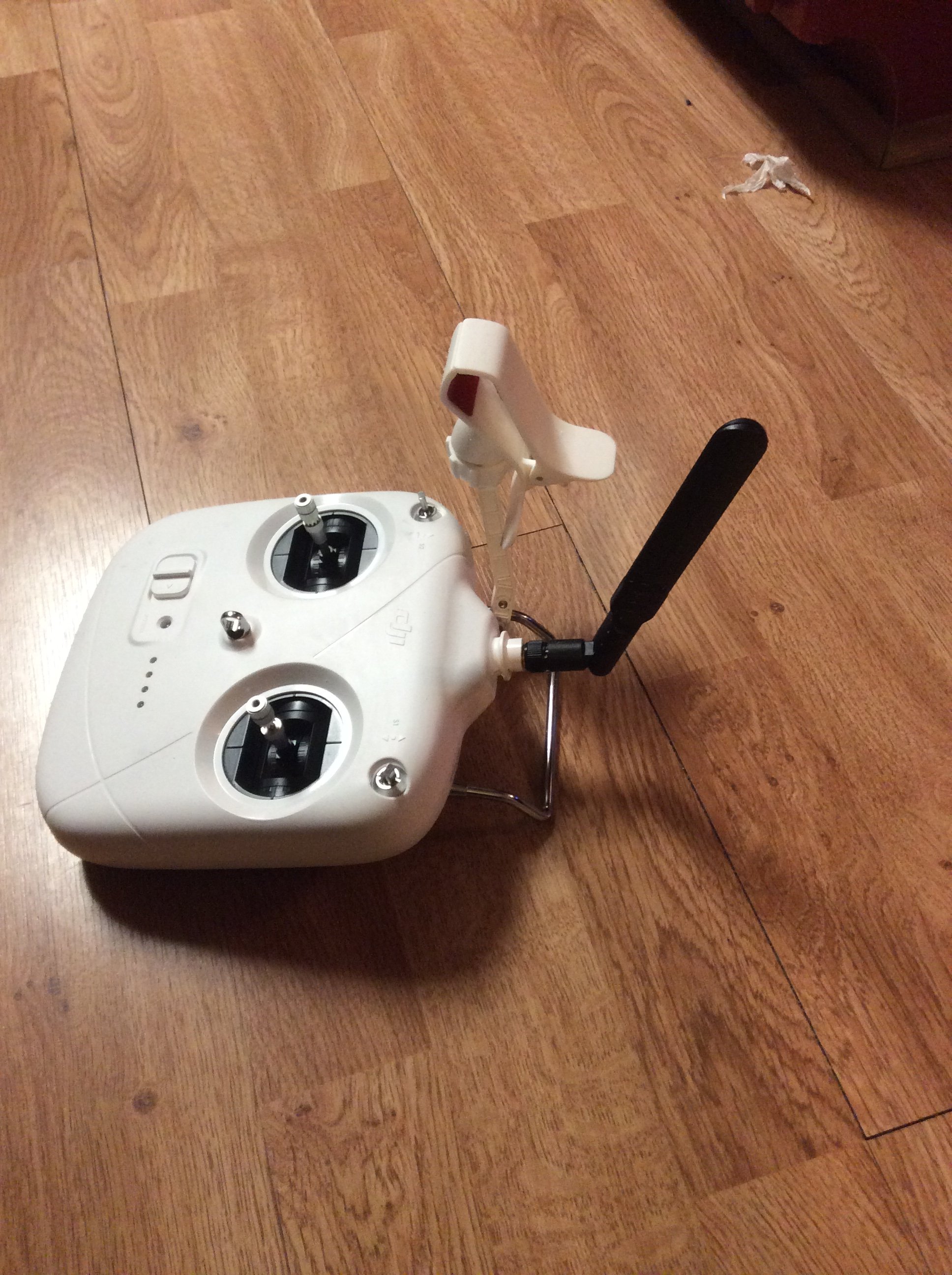

    image.jpeg Got the new cable today, installed the new antenna. Only had a chance to do an altitude test, straight up. Started to get a weak signal warning at about 340 feet, I did make it to 400 foot when I lost signal and and returned home. Repeated the test and lost signal at 375 Feet.
    This was a great improvement, was losing at 165 to185 foot before. But it's still not as good as I would expect. Going. To get a new controller and keep this one as a backup,

    Hi that's good how many dbi is the antenna ?
  14. 509Eagle
    Feb 20, 2016
    6
    the antenna is from a Motorola 5131 dual radio access point 0 I believe its 5dbi.
    Just had time to do a quick distance test this morning, got to 1450 feet before loosing signal and return home, was at 200' altitude.
    once the bird was back home, i took it straight up, did get to 400' but after about 15 seconds lost controller signal.
    During both tests, video was solid. I am still wary of the controller, should I be?
