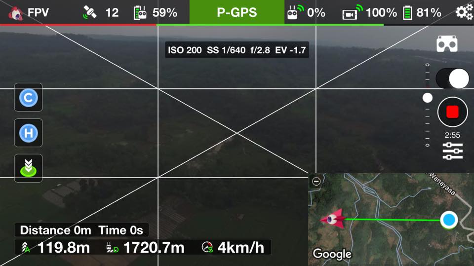

If you want, you can update the tx-power from 17dbm to 27dbm for the 2.4GHz using the script below (use at your own risk). My P3 4K never lose video signal now. Instead rc signal gone before the video signal at 1700m (5600ft)

Pretty sure it can help solve your video signal problem. If you notice, a lot of P3S users complained the reduced range after firmware updates (you can find the thread here somewhere). We are not sure what DJI changed in firmware but some people made a discussion thread here about ftp range mod. It's basically trying to manually change the 2.4GHz video signal transmission power (tx-power) from 17dbm to 27dbm. The video is the fruit of the discussion. What it does when you run djiupdate.exe:
1. It will edit the djiled.sh file in your rc and drone and activate telnet capability.
2. It will save a script watchlog.sh to your rc that can change your tx-power from 17-27dbm.
3. It will edit the djiled.sh file in your rc to enable the watchlog.sh script to run automatically everytime you turn on your rc and drone.
Those steps can also be done manually without the exe file, but If you don't understand what you're doing, do not try to change the files in your rc and drone manually as some people already bricked their rc and drone. Mostly because they edit a file using standard notepad that save the file at 8-bit instead of the 7-bit. This will definitely brick the rc and drone.
However, if you made any modification on your drone prior to this, make sure it is returned to factory setting first. You should also do this at your own risk. Make sure you read everything and you should also see the other video about changing tx-power from 17dbm to 27dbm on youtube. They have several videos and once you understand, you will notice the different and what actually being done to your P3S. Also just in case, you should also see the thread where people get their drone bricked and how they solve it.

Because some P3S and P34K users didn't read the whole instruction and try to change files on their rc and drone and got bricked. I'm not an expert, I just got my drone a month ago and I don't want anyone get into trouble because of the decision they made based on my input. The 27dbm tx-power is definitely working and will increase the video signal. however, before I made the update, I read the whole thing, saw all the tutorial videos and followed the whole instruction to the dot. Now my P3 4K video signal have never been so strong, I lose the rc signal at 1700m but still have 100% video signal. I thought the power consumption will reduce flying time, but so far I didn't notice any different than before the update.
