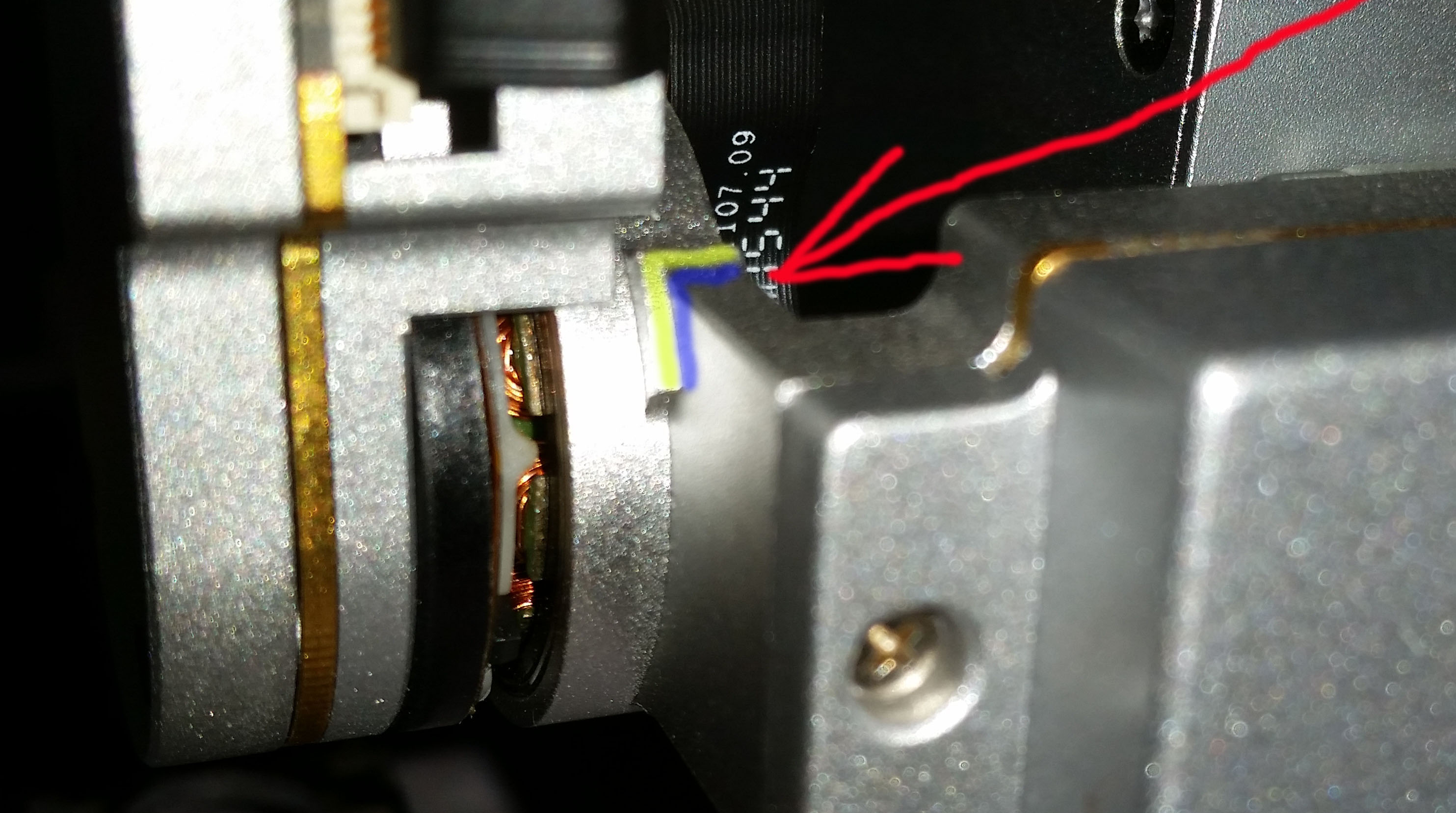

Yes it's correct thereThe notch is highlighted in yellow. Does the area with the blue line, touch the yellow line?

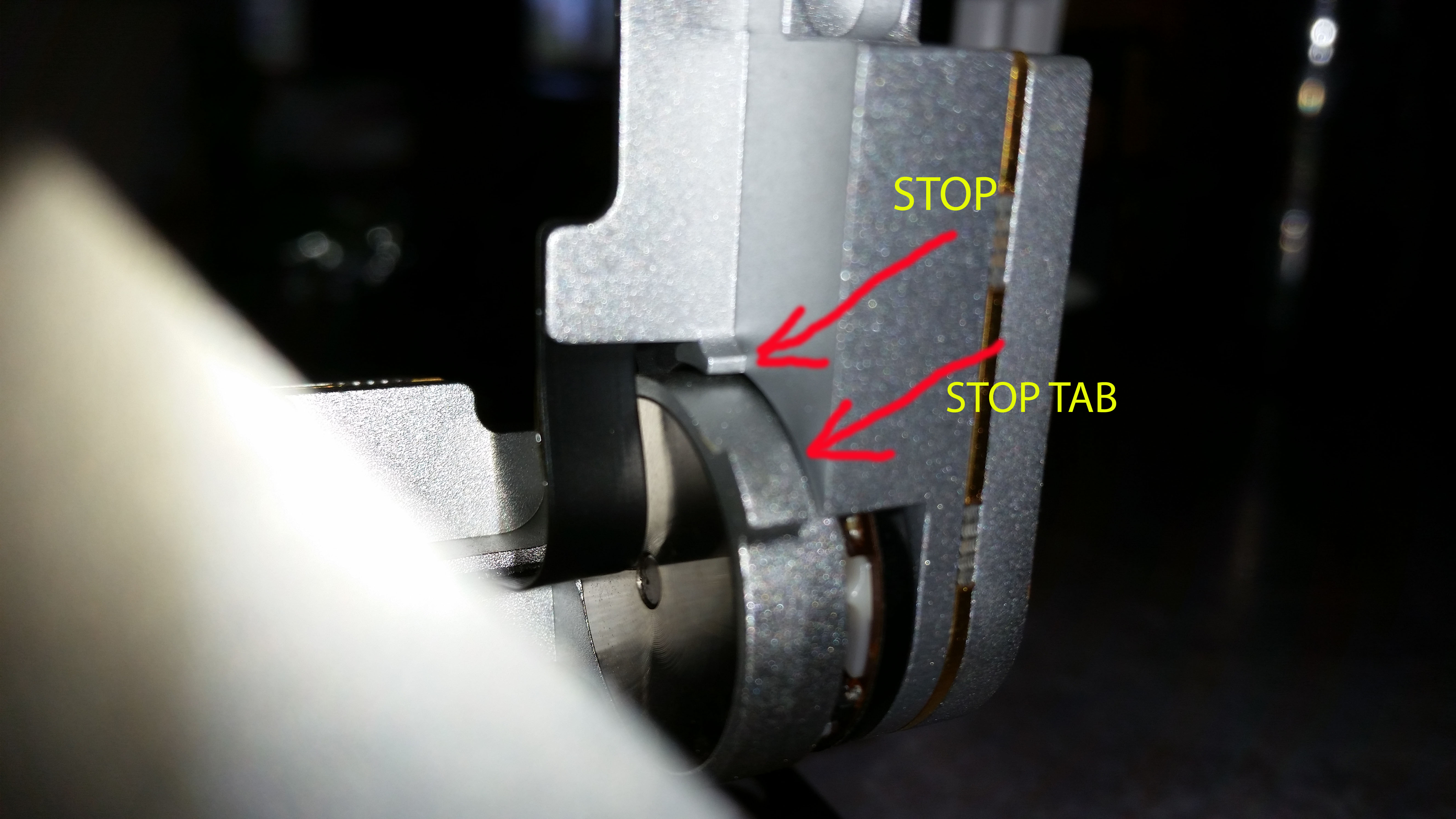

Bro it's midnight 1 here can we contact tomorrow also I'll attach imagesNext image: On the opposite side there should be a stop and a stop tab. Make sure the stop tab has not slipped past the stop, or is similarly stuck.
Yep it's similarly stuckNext image: On the opposite side there should be a stop and a stop tab. Make sure the stop tab has not slipped past the stop, or is similarly stuck.
