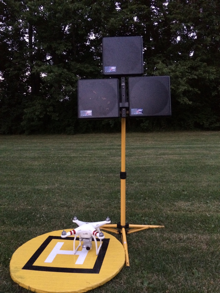

    You mean you haven't tried this yet ImageUploadedByPhantomPilots1467261652.335340.jpg

    Does your landing pad have lights so you can see it at night?
    You need to figure out how to use all that RF energy to charge the batteries in flight.
