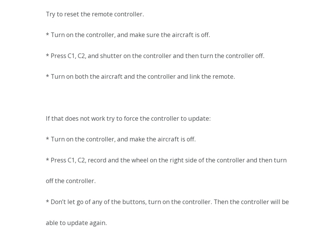

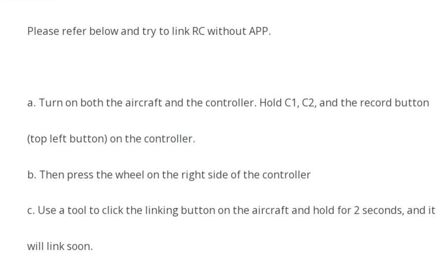

There is linking method without using app,I'll add it to this in a sec,its possible it might need a RC reset so you force the update again ,,
Hope you got enough fingers , Hope this helps I check back soon
The last step seem to work!! They are linked now. The small light on both the RC and the aircraft are now solid green However the two yellow lights are still blinking. I can now connect to the app on my phone. It says that Aircraft requires an update. Tap to view the update tutorial Video. However when i tap it it goes to "skypixel" but i dont see a tutorial.
