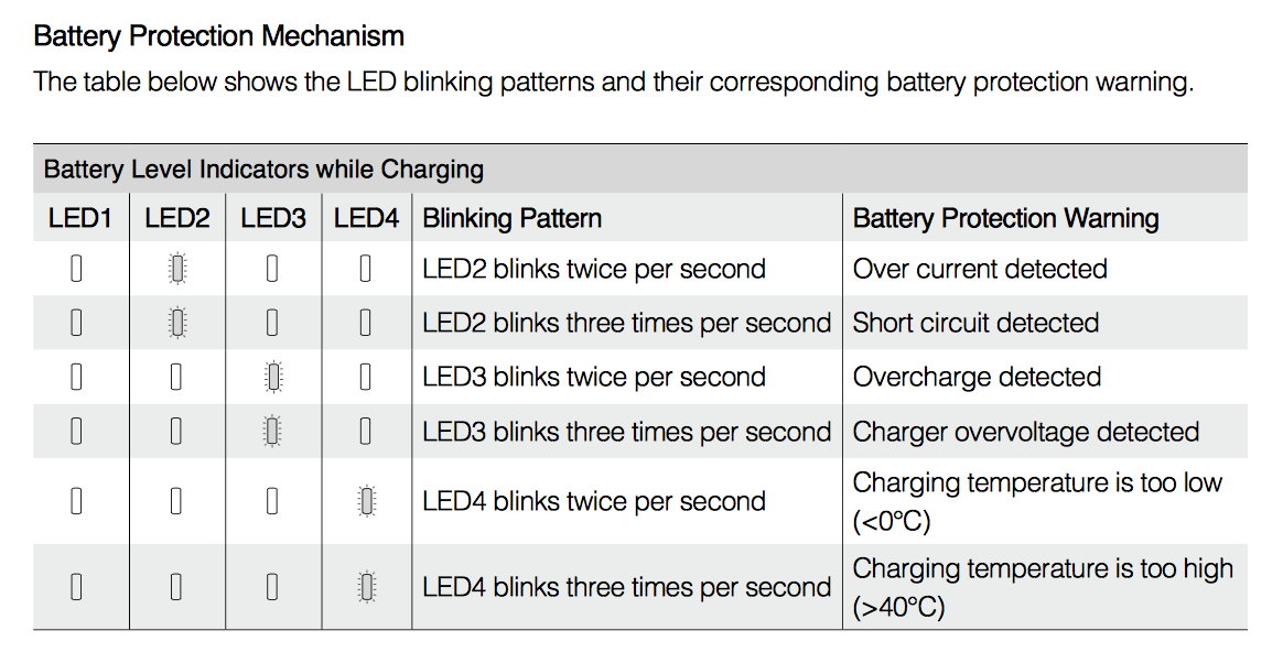

    Always check the online manual or just download it for easy access. You will find the following chart in there. If the battery is hot battery, let it cool first. If it is not hot, consult the chart below. If it turns out to be a defective battery DJI may help you out with it.

    The chart you're referencing does not show any blink patterns for LED 1. That's what the OP posted above.

    The graph does not show what my battery seems to be doing.

    The last one, over heat - LED4 blinks 3 times per second.
    There are no LED1 warning codes.
    EDIT: Huh, that is LED1 isn't it. I had it backwards.

    Bingo. I believe that's why the OP is posting here ;)
