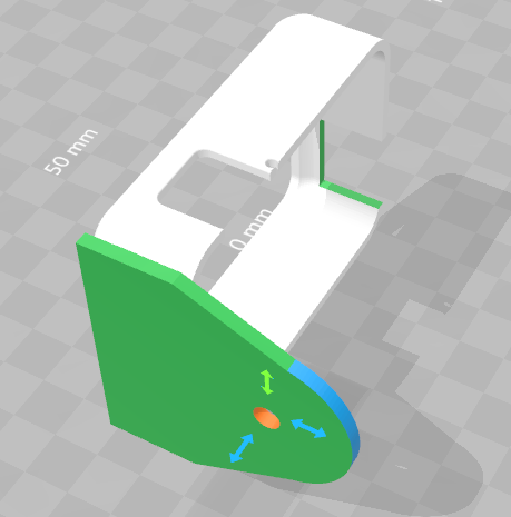

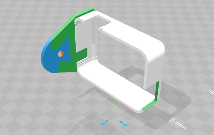

I think it would be possible to 3D print a replacement for the part that the GoPro actually sits in. I was also looking to see if there was a way to do this. I need to actually get my hands on hero 5 first. in theory, all we would need is to replace the "Cup" portion the hero backs into. I have Lightbridge on my P2 so the Hero5 mini HDMI out would work for me.
Feb 20, 2015
27
Here is what I am trying to get at. By strapping the Hero 5 to the Zenmuse as is, the Hero is too front heavy and the gimbal will not be able to tilt the camera up. If we redesign the "cup" and move the camera back a little, the gimbal should be able to level the camera. There would be a lot of trial and error to get the weight balance correct but I think it can be done. I would need a broken H4-3D to take apart and a Hero 5. Any thoughts?
View attachment 98959 View attachment 98960
