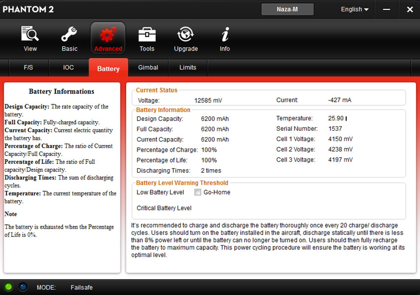

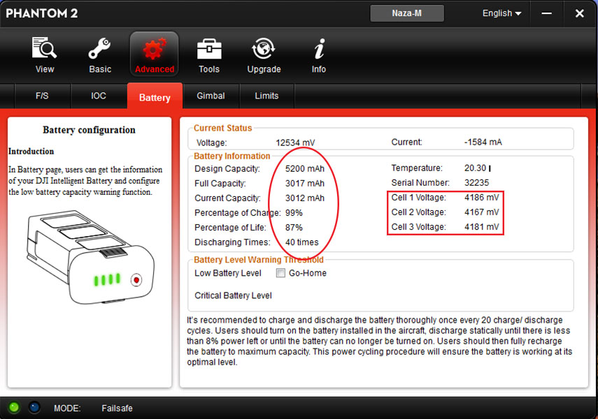

    A better question is was the craft a new or used purchase. You should spend some time checking those batteries if they are used before and after charging even with new batteries.
