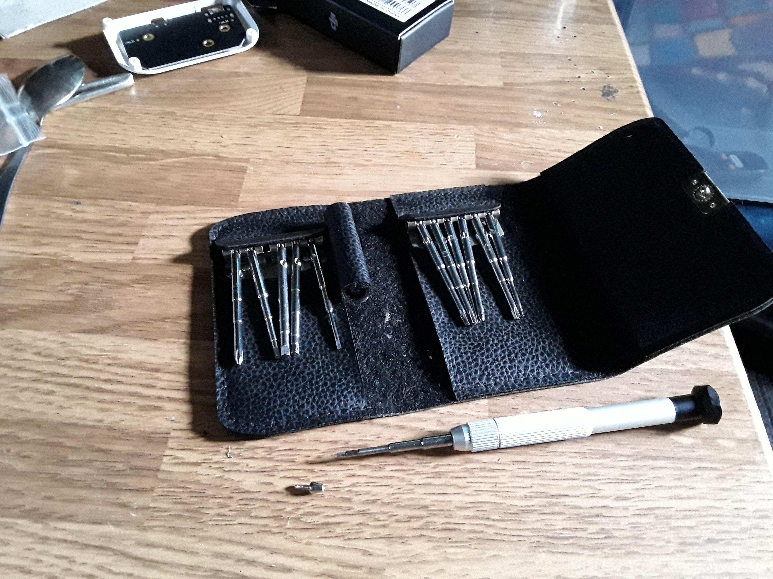

Can you tell me what I need to get the old one off the screws are so tiny and I don't have the right tool. Thanks
..order yourself a set of these.phantom Allen key set off ebay,cheap as,size is 1-5mm ,hardware store should sell similar set if your neighbor got none
,,screw size 1.5mm
Just a heads up on being carefully with tabs that lock ribbon cable in place,they are brittle plastic so gently lift till clip opens to release ribbon,I use very fine flat screwdriver to help lift clip up
View attachment 96763,,screw size 1.5mm
To the OP - just a small correction - Actually, the tools you need are not Allen keys/(aka Hex keys), but 'Torx' head keys.. Allen keys are something completely different.
Thanks for that ,wonder what they were called,learn something everyday :)ps,very handy set too
Reactions: Steve7777
What size? This is totally new to me and I see that Lowes sells these but I don't know what size to buy. Got a size for me.
As ianzone wrote in post #7, the cover has 1.5mm torx screws and the circuit board is held in with small standard Phillips screws. If you buy a good inexpensive set it should cover all your future needs.
