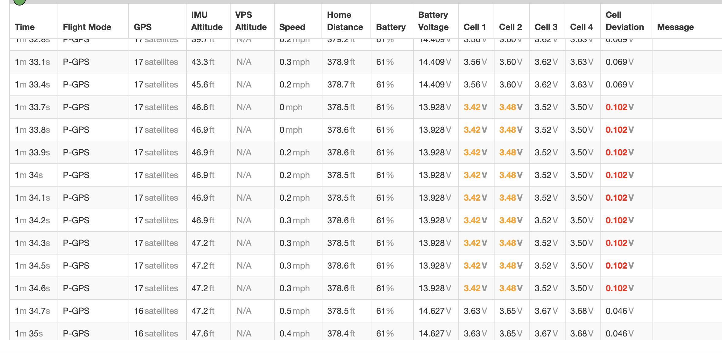

Do I need to be concerened about the battery cell deviation at a couple points? actually looks like I was hovering (0mph) the 2 times it shows in the log.
I noticed that on one of my flights yesterday. It wouldn't be surprising. I've had the batteries a long time and they've barely been used the past 3 years since I got the P4P.
But I do keep them 40~60% and check every 3 months on the charge.
there was another few sec. of deviation towards the end of this flight 7m34s- again hovering or even just running while on the ground for maybe 2 sec. total.

Do I need to be concerned about the battery cell deviation at a couple points? actually looks like I was hovering (0mph) the 2 times it shows in the log.
Batteries degrade over time and don't last forever.
Those numbers look pretty good considering the age of the batteries.
Some deviations are normal.
Here's what Airdata says about cell voltage deviations:
Minor Deviations
Minor deviation is when a cell differs more than 0.01v from the other cells. The total amount of deviations per cell is then divided by the total amount of flight minutes, to get the number of minor deviations per minute.
Note that even a perfect battery would have minor deviations and it is normal. Lower values are better. Higher values may provide an early sign that the battery is not as efficient.
Major Deviations
Major deviation is when a cell differs more than 0.07v from the other cells.
Please note that normal batteries can have a few of these.
An abnormal battery will:
A) Have most of the major deviations in one cell
B) There will be multiple major deviations per minute, and more than 10 total
C) The deviations continue longer than 1 minute
If your battery shows all symptoms (example, another) then this is considered a more severe case of an inefficient battery and may impact the battery life.
If your battery has only 1-4 instances on the same cell, don't worry too much about it. If it has 5-10 instances - then continue to track and make sure it does not degrade.

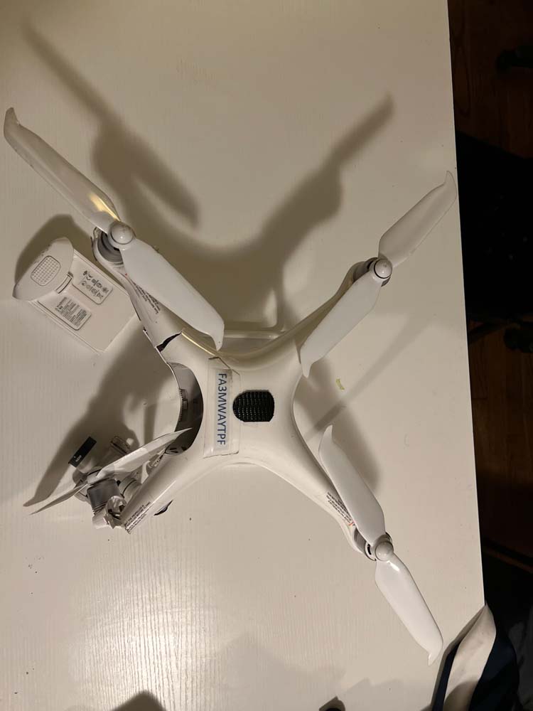

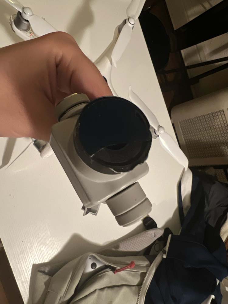

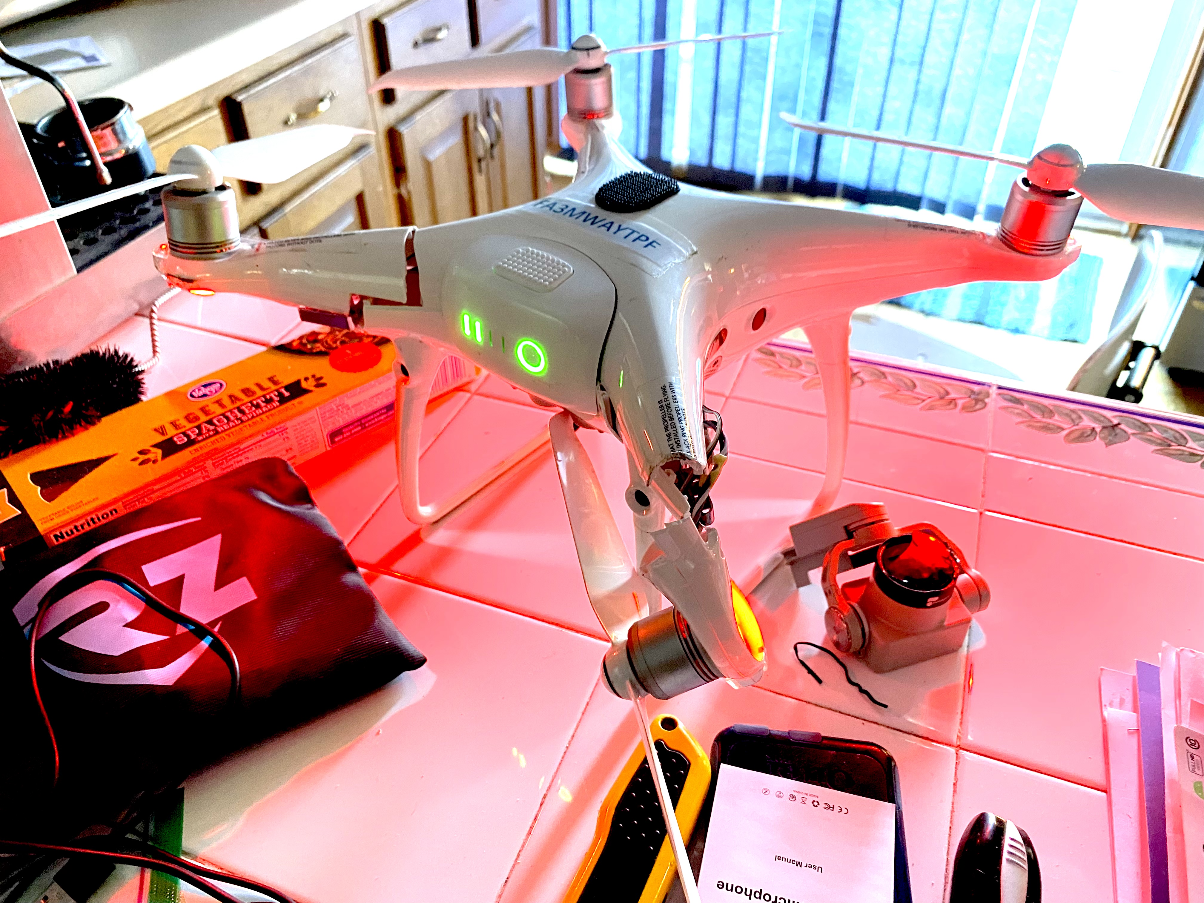

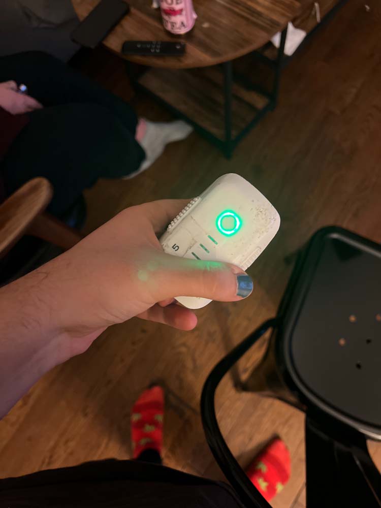

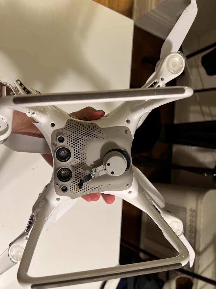

Picked it up from my Good Samaritans- 2 UIC students.
I am seriously amazed. It was probably up in a tree for almost 6 weeks. During that time we had some heavy rains.
They found it in the sidewalk a couple days ago.
Battery is charging now. No damage to it at all.
I put another battery and fired it up, Got a message that there was a mismatch in the device firmware. So I’m not sure if it was that I updated DJI go 4 or there was something that wanted to update in the drone itself. possible it’s that I updated the iOS on my iPad and it was saying there was a mismatch between the transmitter and the iPad. I’m not sure. It didn’t take as long as a real firmware update for the drone itself.
But, the bird did start up, and all the lights came on, the propellers did their little wiggle dance at the beginning, and gave me the impression that it would’ve started up the motors if I tried , but with one arm hanging off, and the other one cracked I wasn’t going to try. I am going to send it to DJI and see what they say. It’s just good to know what happened to it.
My main concern at the time when it lost connection was that it might drift into something and cause damage or harm. I’m glad that the auto land feature when you lose connection did what it was supposed to do.
