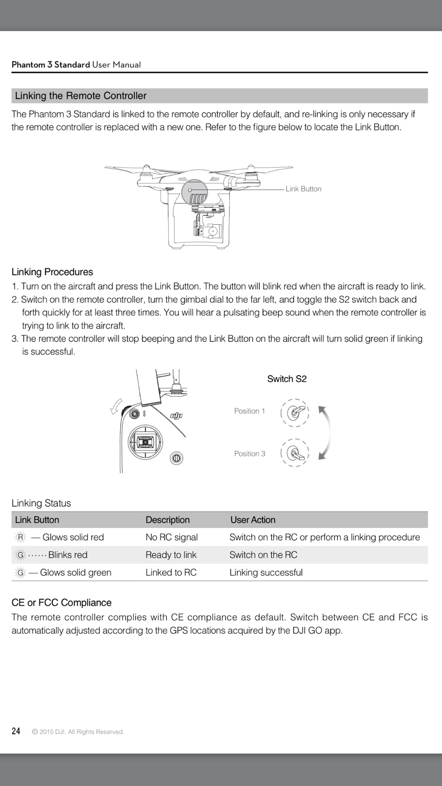

    Try to delete the app, reinstall it and see if it works. Or link the controller per instructions below

    Tried reinstalling the app earlier and it gave me the same error message. I followed the instructions for reconnecting and allowed the RC and P3 to try to connect for ~10 minutes with no luck. The RC just keeps beeping and the connect button blinks red. Any other ideas?
  4. mandalay
    Nov 28, 2015
    743
    190
    If the link button blinks red, it means it's ready to link. The manual says you need to turn on the RC. Did you do that?
  5. mandalay
    Nov 28, 2015
    743
    190
    If you already did, try this.
    Go to the RC menu in DJI Go app. At the bottom there is an option to relink. Then on the left side of the drone, there is a little hole with a red light; easier to see if it's up side down. Use a paper clip to press it. Turn off the drone, RC, and close the app. Then turn on RC, launch the app (make sure it's connected to RC's wifi), and turn on the drone. The light should turn green after it's linked successfully.
