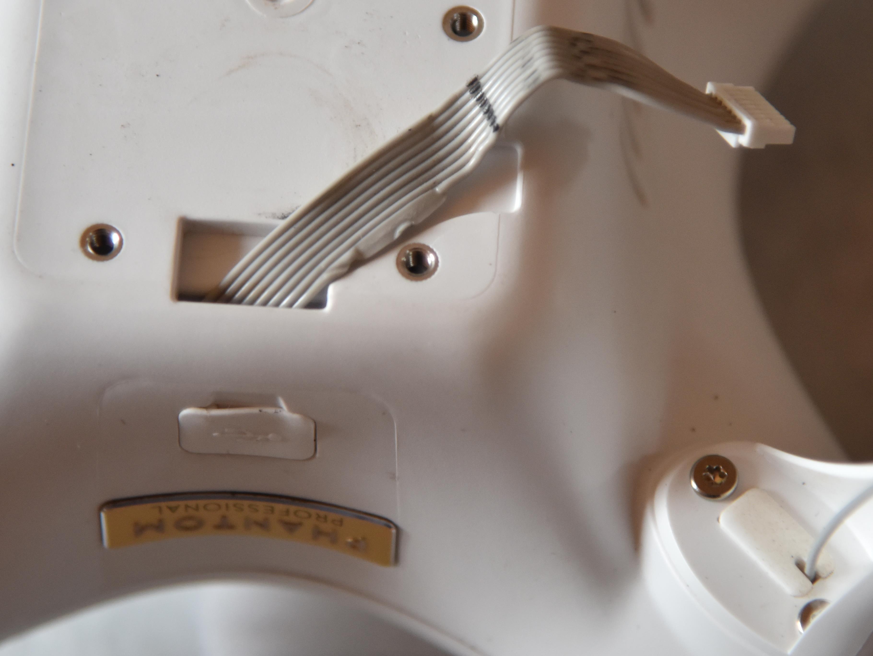

Maybe you have some issue with the cables between the gimbal and the birds.
Also with this kind of hit, you can have also some unexpected damage.
In mine, I was surprise to see that some flat cable was almost pre damaged during manufacturing as the gimbal support plate was tighten with that cable not at right place and I am always afraid that it get defective if I come to same situation as you.

Was a little more than bumpy landing ;)
