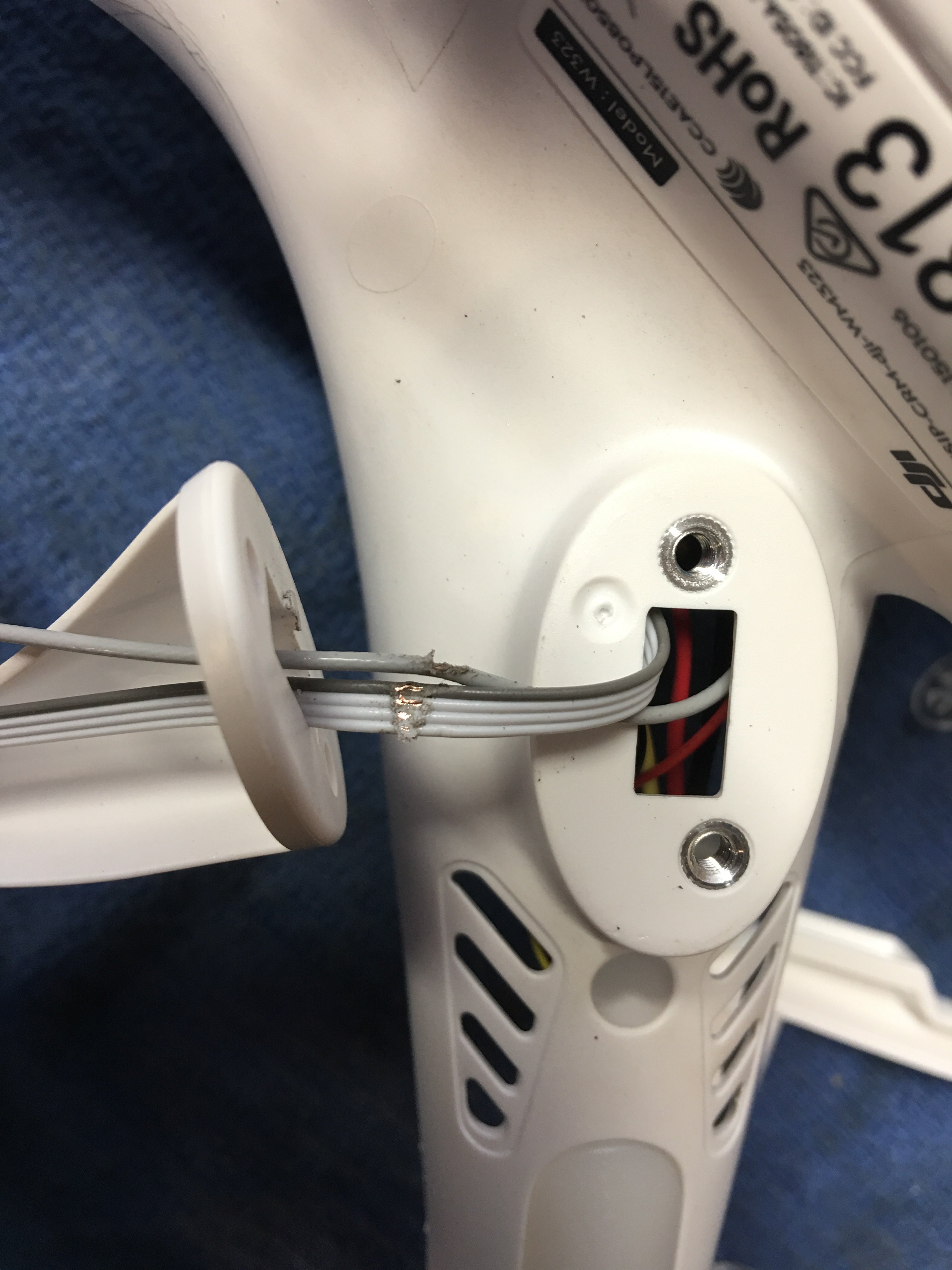

    image.jpeg Went to replace my bent landing gear today and got all the way to buttoning the shell back up and accidentally frayed the wire to the compass and also one antenna - should I send this out to DJI or a certified location to get fixed or can I solder these wires?
    Should I just bite the bullet and get a re-casing done on the whole rig? My current case is a little banged up but still operable.
    Only had this quad for a few weeks - got it for a steal on Craigslist
    Any help is appreciated!

    If you're going to do it yourself, I'd suggest you replace the parts. Here's what you need:

    If it were me I would replace the shell when you install the new antenna and compass. A new shell is only about $60. Or you could go with a Hydro Dipped shell for about $150 and make it one of a kind. See Liquidschades on here. They do a great job. IMG_3656.JPG

    Honestly I'd just put a dab of plasticote, epoxy, or hot glue over the exposed wire & carefully push it back into the shell. The wires don't appear broken & the insulation is only partially compromised. Once inside the bird those wires don't really move around.
