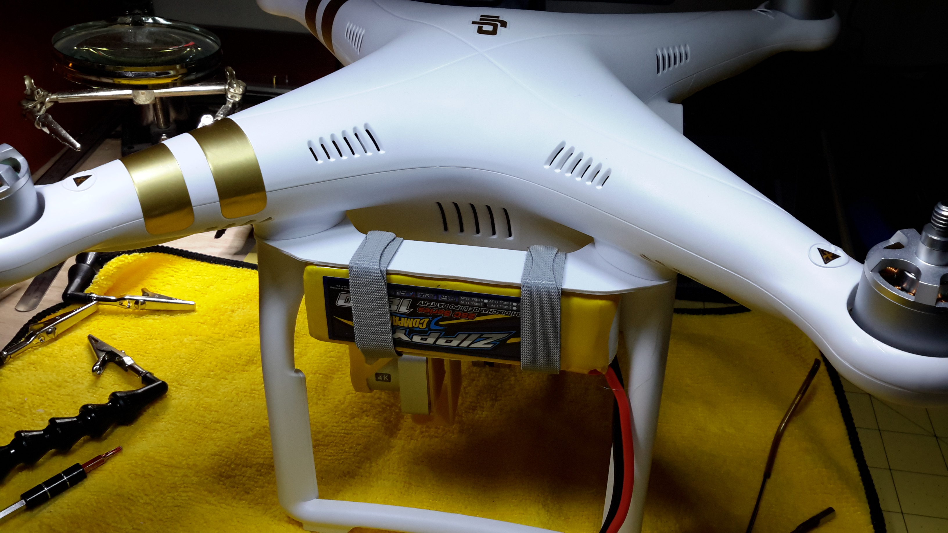

    I've got a battery mod on mine that carries over 400 grams of extra batteries and the P3 flies like it doesn't even know the weight is there. 20150813_230357.jpg

    On behalf of all who want to know.....link for the added battery support please.....

    Handmade those ... no link, sorry
    Not sure... there gets to be a point of diminishing return with batteries so "going bigger" doesn't help anymore... haven't tried more weight than that.

    Did you weigh the batteries ? Just received my 2200 Zippys, 204 grams each. Will it be flying well you think ?
