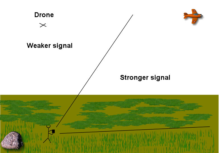

    Transmitted radio waves go in all directions, BUT can be made more directional when designed to, as in the case of the controller. In my opinion, If your bird was truly "straight up" from your position, the antennas on the controller were technically not in the optimal position, "relative to the drone", that is. Optimal position is the flat sides of the antennas pointing generally towards the bird, which is the case when it is out away from you. In your case however, with the drone directly overhead, and the antennas pointing straight ahead, that would orient them 90 degrees off relative to the drone.
    Others, please chime in if I am all wrong about this.

    Exactly right. Even if you rotate the controller so the antenna's flat sides are facing up the bird's antennas are still oriented wrong (pointed straight down).

    You're not wrong. Its also what I noted earlier regarding how the antenna are placed on the P3.
