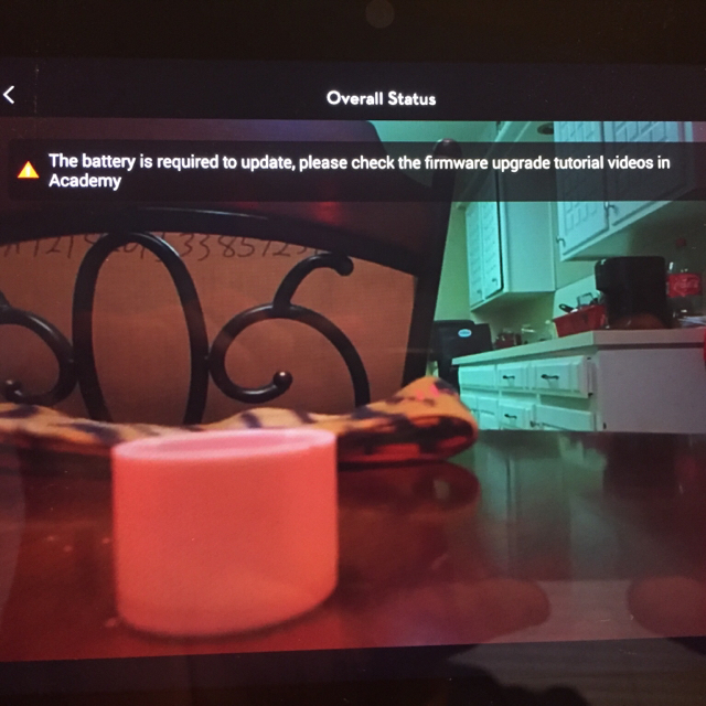

    Ok guys I guess I missed something I did the latest firmware update last week and since its been snowing here in Texas I have been waiting for a decent day to fly. I picked today to fly and I got this can someone please tell me how I do this update?

    Put the .bin file for the latest firmware (1.6.040) on the root of the Micro SD card as if you were updating the aircraft. Power on the remote and then the aircraft and, if your Phantom is already on this firmware, the battery firmware upgrade process will take place. It takes about 2 minutes per battery and you have to do it for every battery you have.
