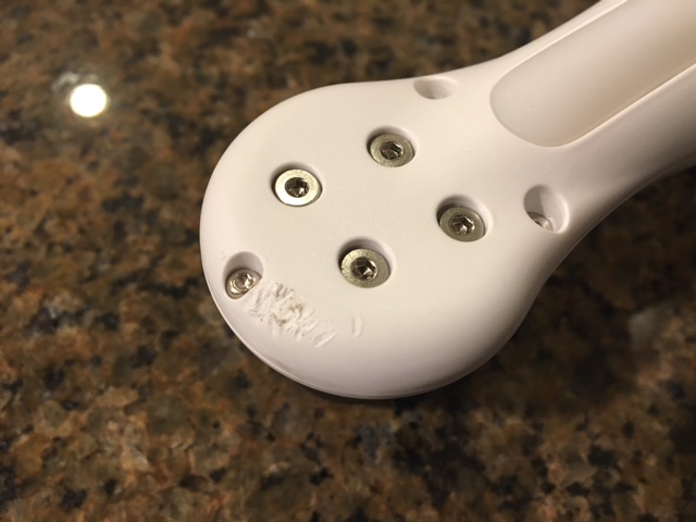

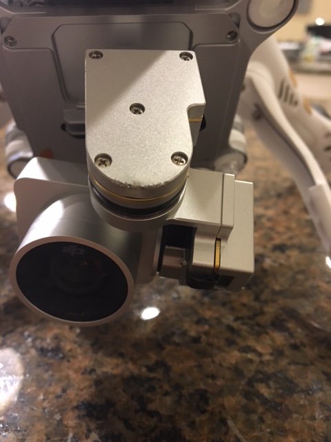

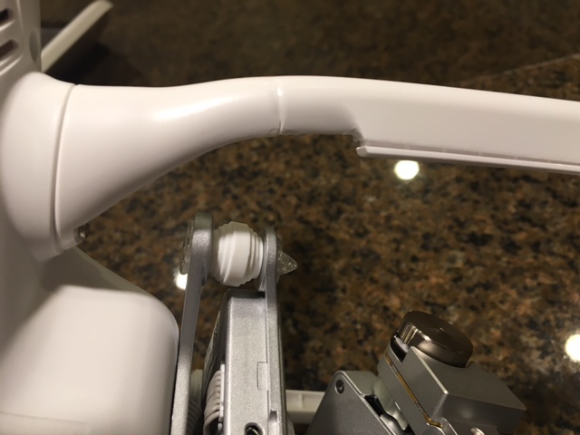

  6. mrdave543
    Jun 2, 2016
    74
    19
    See attached damage, and let me know if think worth sending in:

  9. WetDog
    Oct 18, 2015
    1,495
    647
    No, that'll buff right out....
    As long as it flies OK and the motors are not moving and the gimbal works you should be fine. Replace the props, even if they look OK (they're cheap and if they have any sort of weakness, you may well have another exciting crash, this time from 200 feet).
    But once you figure out the initial issue, start the AC without the props, check everything out that you can (gimbal movement, calibration, check your sensor values). Put the the props on, spin it up. If that seems OK, pop it in the air.
