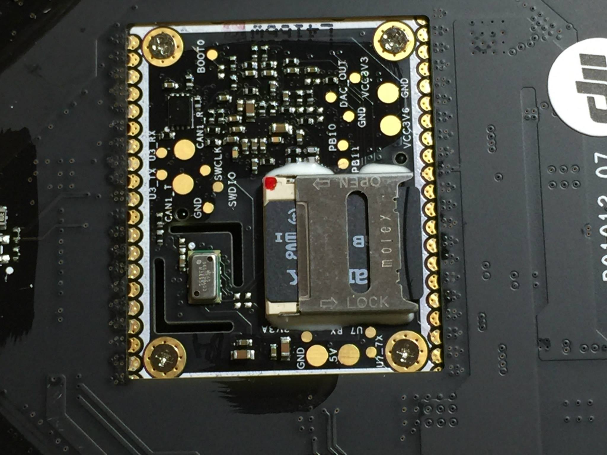

    There's a memory card on the back of the RX ??? :)

    That card stores the detailed log files, the only way to access them is to attach the bird to the usb port directly and put it in data mode.

    yes, i knew it was a black box memory card, i just thought some people may be surprised about it.
