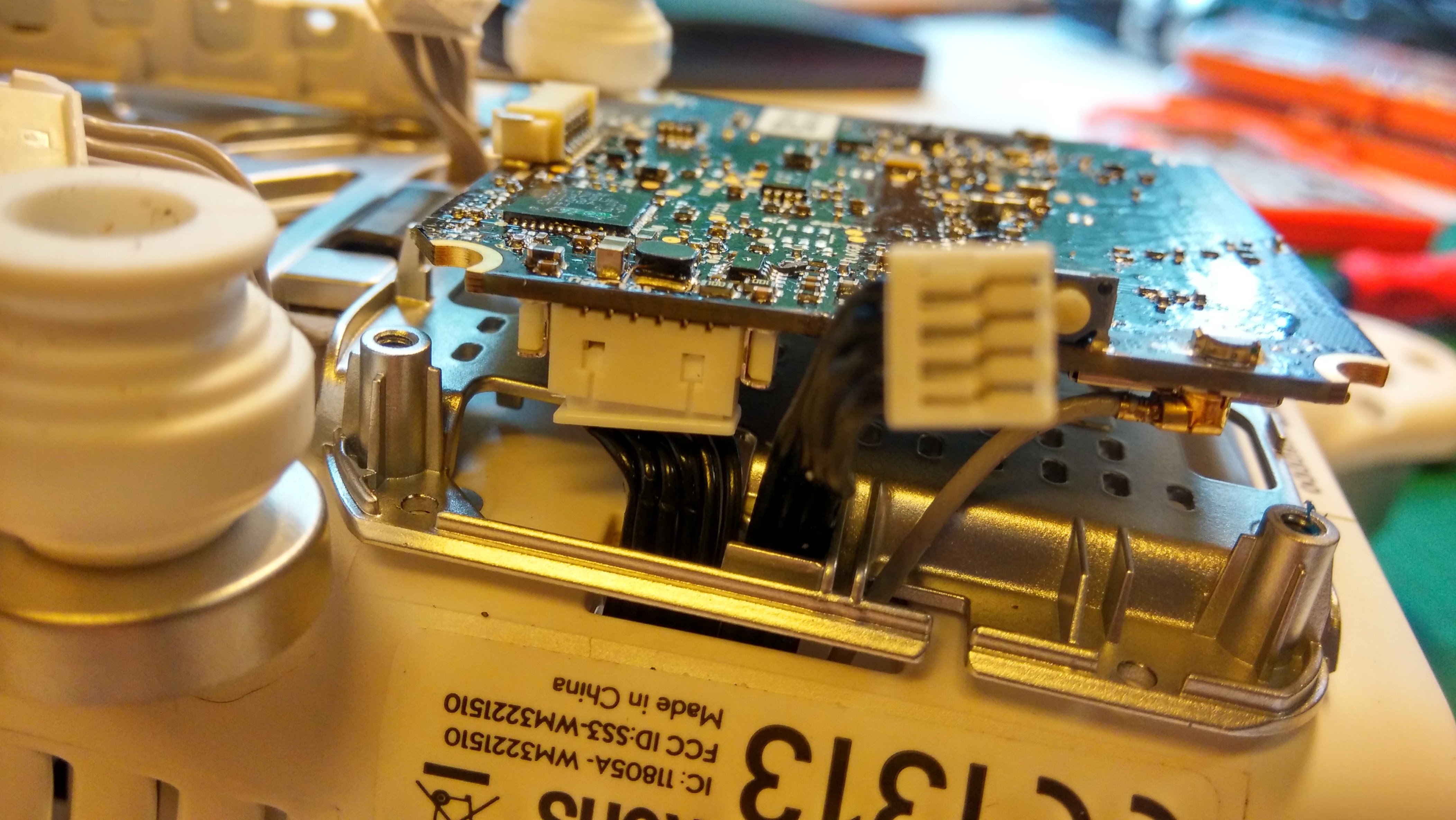

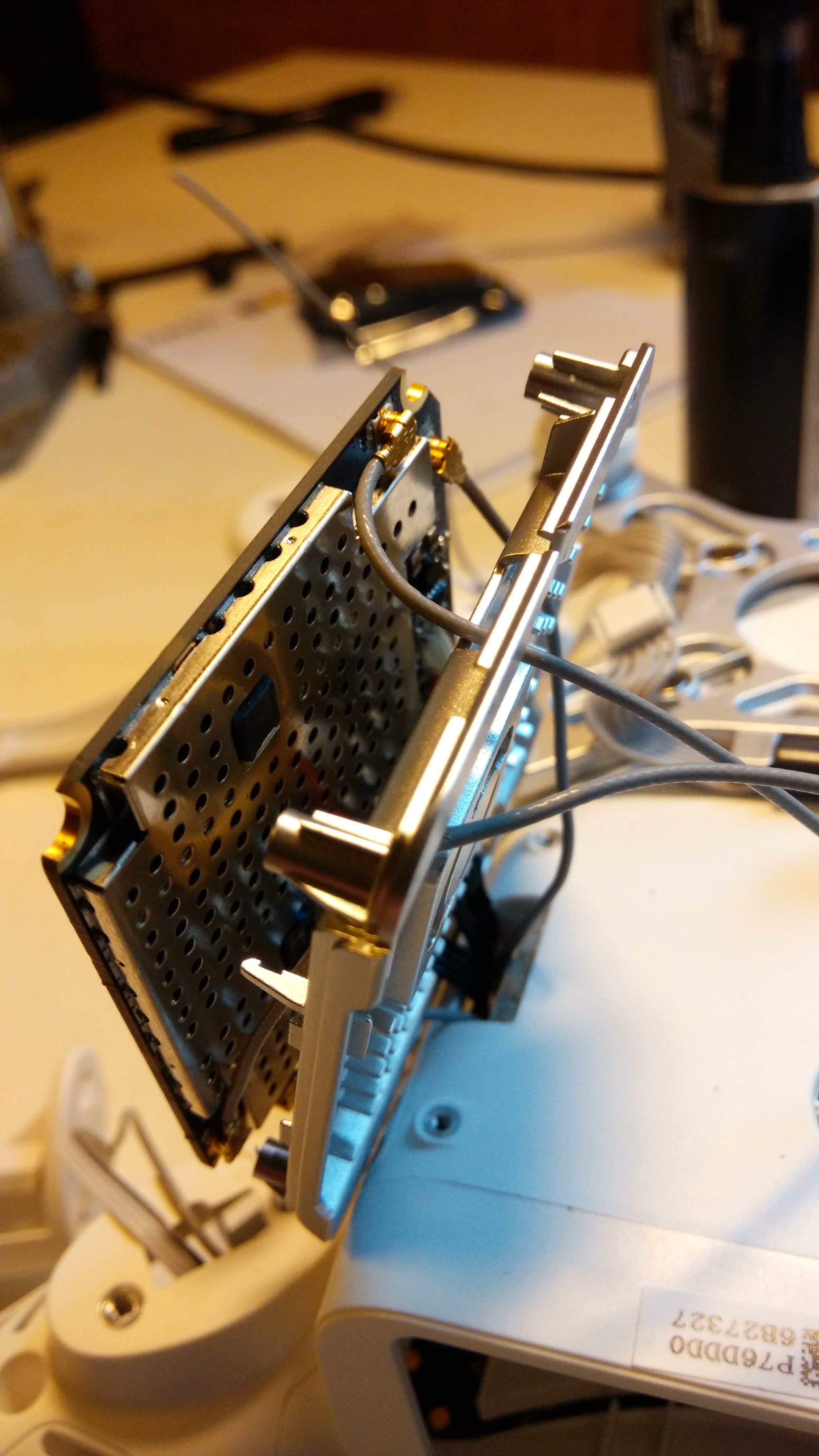

    You can access the ULF connectors by just opening the vision controller unit at the bottom. All 4 antenna's connect there. But TBH, as I understand, those 4 antenna's are 2x video and 2x control and they are redundant. It doesnt seem likely all 4 would have the same intermittent contact.
    If its not the remote control, then its more likely one of the connectors between the lightbridge/VPS module and the mainboard. You can check one side by opening the VPS unit:
    To check the one on the mainboard, you need to take the shell apart.
