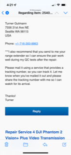

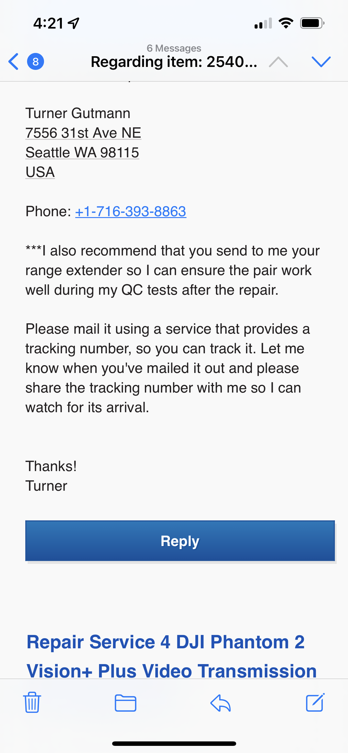

Yes you can get it reflashed. Get in contact with the guy in the attachment. You send him your Wi-Fi module and your range extender and he fixes it and send it back to you. It does cost around $80 but he warrants it for life. As long as you power it up once a month it will keep working.
