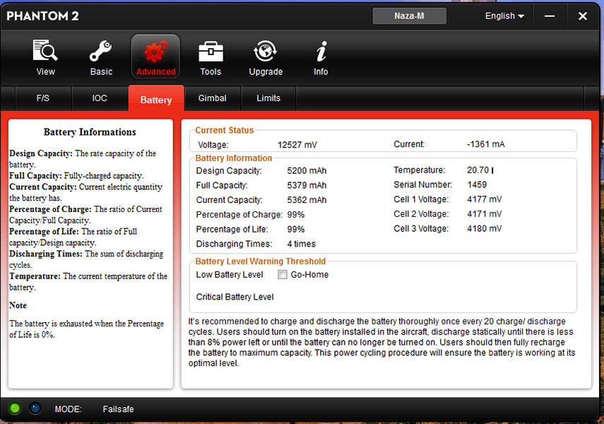

  17. jason
    Oct 12, 2014
    4,723
    479
    Commerce Twp,MI
    Do you ever check current after charging your batteries as the are just as important as the cell voltage.

  19. jason
    Oct 12, 2014
    4,723
    479
    Commerce Twp,MI
    Here's two from a 6000mAh battery.
