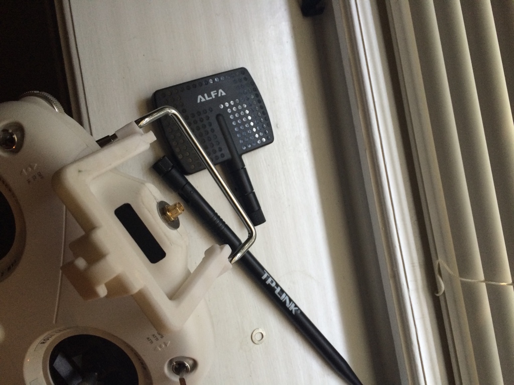

Alright another question for you:
Has anyone upgraded the antenna on their tx and had range either stay the same or decrease? I did this mod today on my controller after finding an open box new one on eBay for 34.00.
On the new controller, I get 1200 meters before FailSafe. On the modified one, I get about 1050-1000m. This is using a Tp-link 8dbi omni direction or an Alfa 7dbi panel. I've even replaced the u.fl RP-SMA cable just in case.
I was just expecting some gain, however marginal. I was meticulous during the removal of the silicone and the connector within the tx seems perfect.
Anyone else have a similar experience?
Scorp

hey man, I just did this a few weeks ago n no problems at all im not fly too far but is good

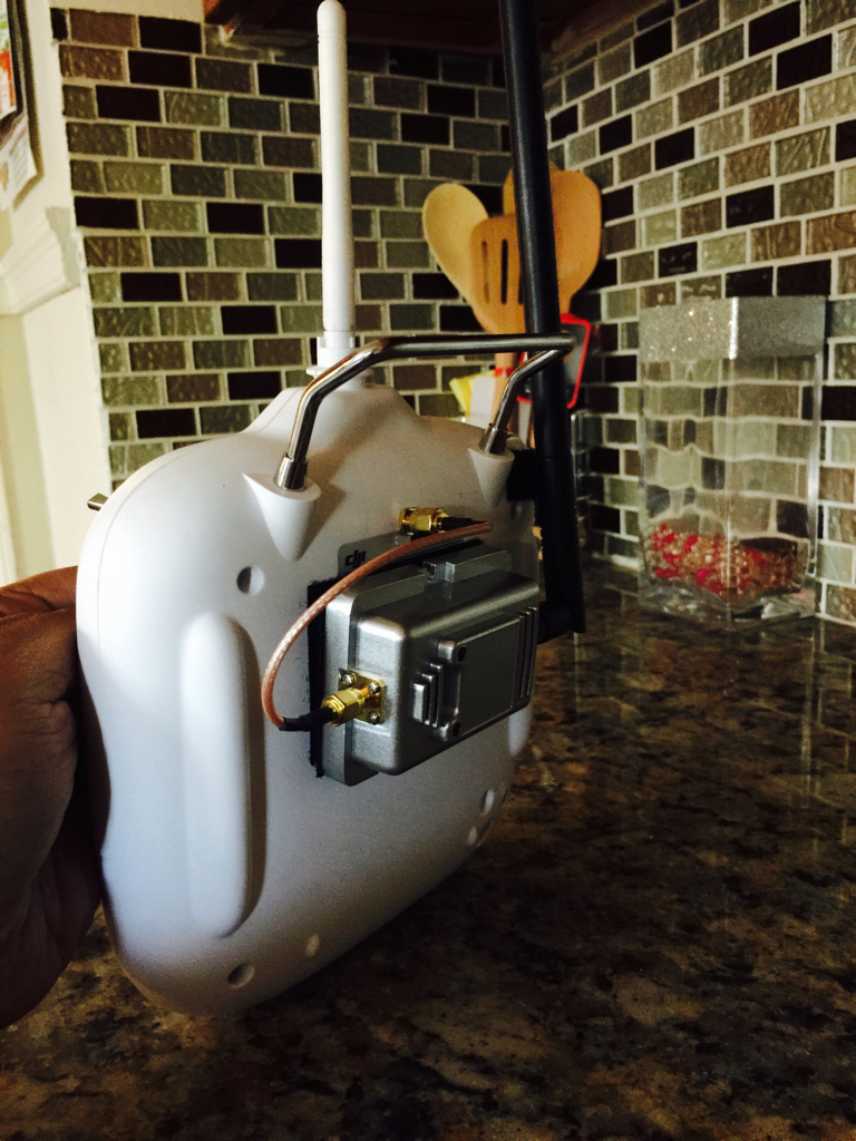

This is the mod I got do on my controller wifi booster I disabled the original antenna just kept it in there as I wanted to keep my controller looking really high tech lol
