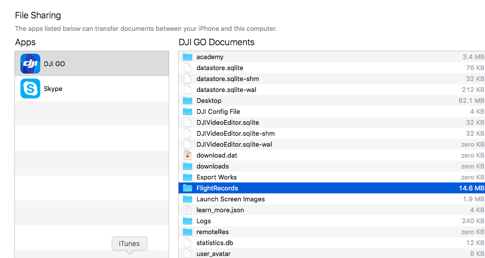

    If my phone lost GPS though, why didn't the home position ever appear to change when I went through the flight log in real time on the DJI Go app? Either way, I gotta figure out how to get these logs off of my P3

  12. robinb
    May 10, 2014
    3,012
    527
    you can get them off your phone directly.
    connect to iTunes and goto iPhone with phone connected via lead in that, make sure phone is not in standby and scroll to bottom of page.
    you will see file sharing. select go app
    drag the whole flight logs directory to your desktop.
    from there you can upload to healthy drones

    May 10, 2014
    3,012
    527
    Remember you can only transfer when iPhone is active and not in standby.

  15. Michael Speziale
    Nov 24, 2015
    18
    Thanks for the instruction :) I'll do that as soon as I can and upload to healthy drones
