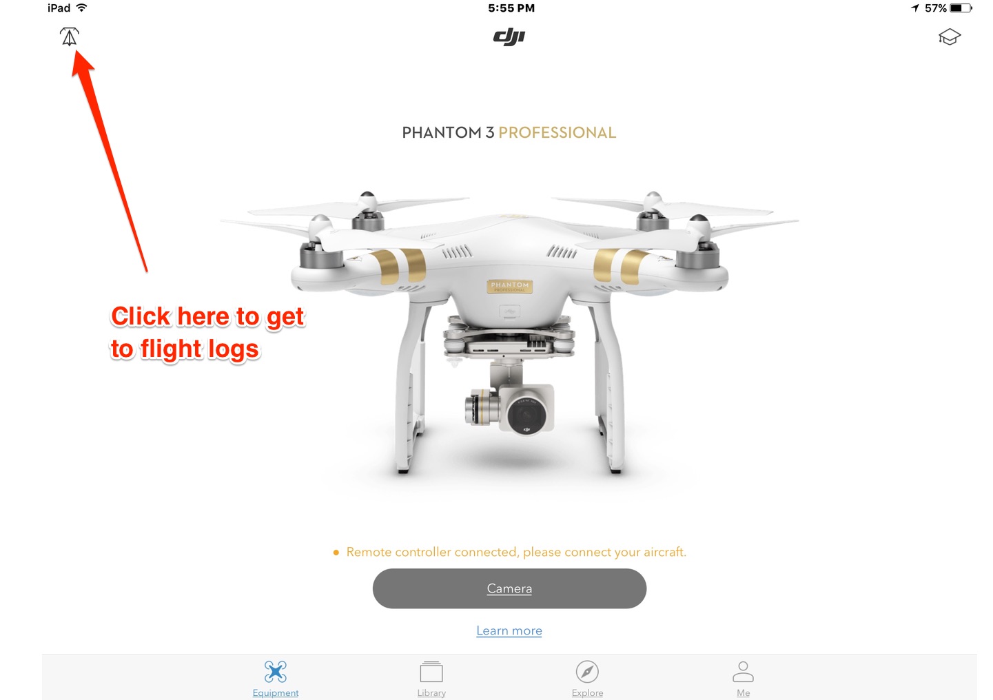

    Anyway, the first thing I noticed is I am not sure where to find the flight log. I couldn't find an obvious feature in the DJI GO app where it would be. The little map in the corner showed me a squiggly line initially, which is obviously where I had gone. But, I was searching for a way to save it and access previous flight logs (of which there are none yet), and I clicked what looks like a pencil eraser; it removed the squiggly line without any prompt or message. I also looked on the microSD card in the P3A, and there was just the video and photos I took.

    Start the app and click on the icon in the upper left corner. Do not enter camera view. There are your flight records.

    From the startup screen of the APP click the icon in the top left - that will take you to your flight logs.

    Yes! There are the flight logs. I had clicked every UI element except that one.
