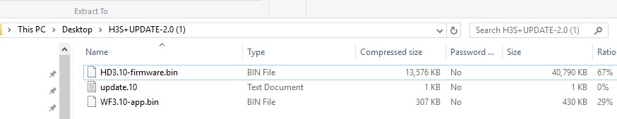

    Thank you for the reply. When I download the software from here; (Download GoPro HERO3+ Silver Edition Camera Firmware 2.0 for OS Independent) I get a zip file. When I unzip the file, I get 3 files. 2 bin files and the update txt file. I have tried moving just the txt file and that didn't work. I also tried moving all 3 files (the 2 bin files and the 1 txt file) onto the sd card and then putting that in the gopro and turning on the gopro. It does not automatically update the camera as it says it will in the directions.
    Here is a screenshot of the 3 files in the unzipped folder.
    Am I missing something?
    Thank you!

    And that is simply because you didn't put those three files into a master file called UPDATE. Then take file by either dragging or coping it to the SD card. If the file doesn't say it will not load into your camera.

    Ok, so I have to create a file named update. Got it. I will try that now, thanks for your patience with me.

    That seems to have done the trick, the camera is currently operating. Thank you for all of the help, hopefully this will get me back in action with my Phantom 2.
