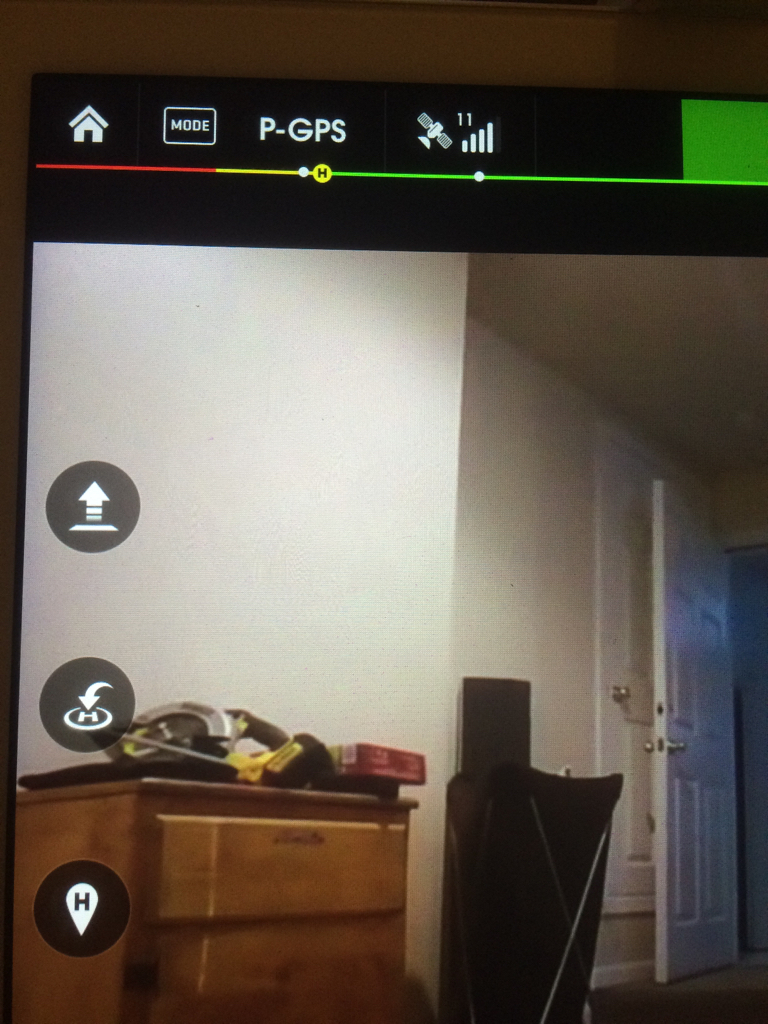

    Just went to fly around today in front of my house where I have flown many times before and it stuck in Atti mode. It's not showing any satellites but flys just fine in Atti mode just a little more difficult to control.
    Here is a picture of the pilot app when I switch the remote from A to P
    I haven't had any crashes but wondering if there is a plug that could have come unplugged somehow or a setting in the app I might be not seeing. Thanks for any info.

    I was just dumb.... I had taken the top cover to check on what I thought was a crack and forgot to plug the gps receiver back in.....
    Back to normal with 11 satellites indoors!!

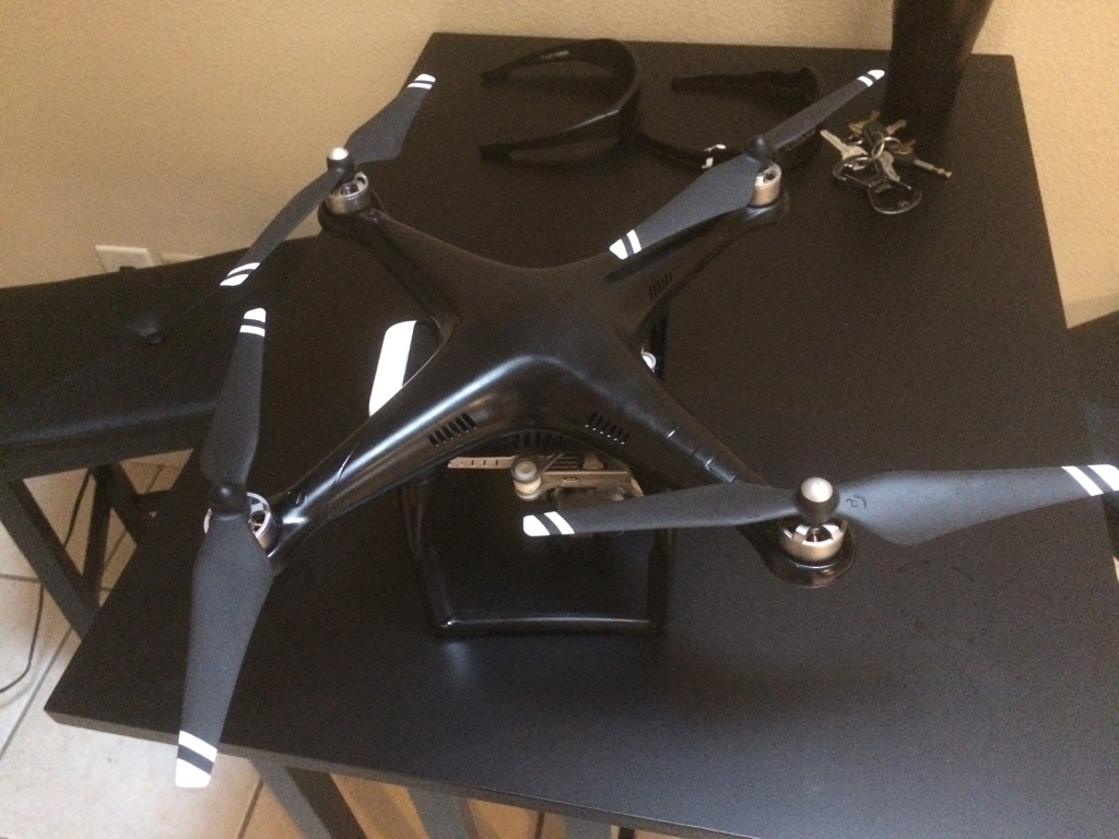

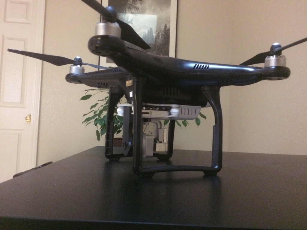

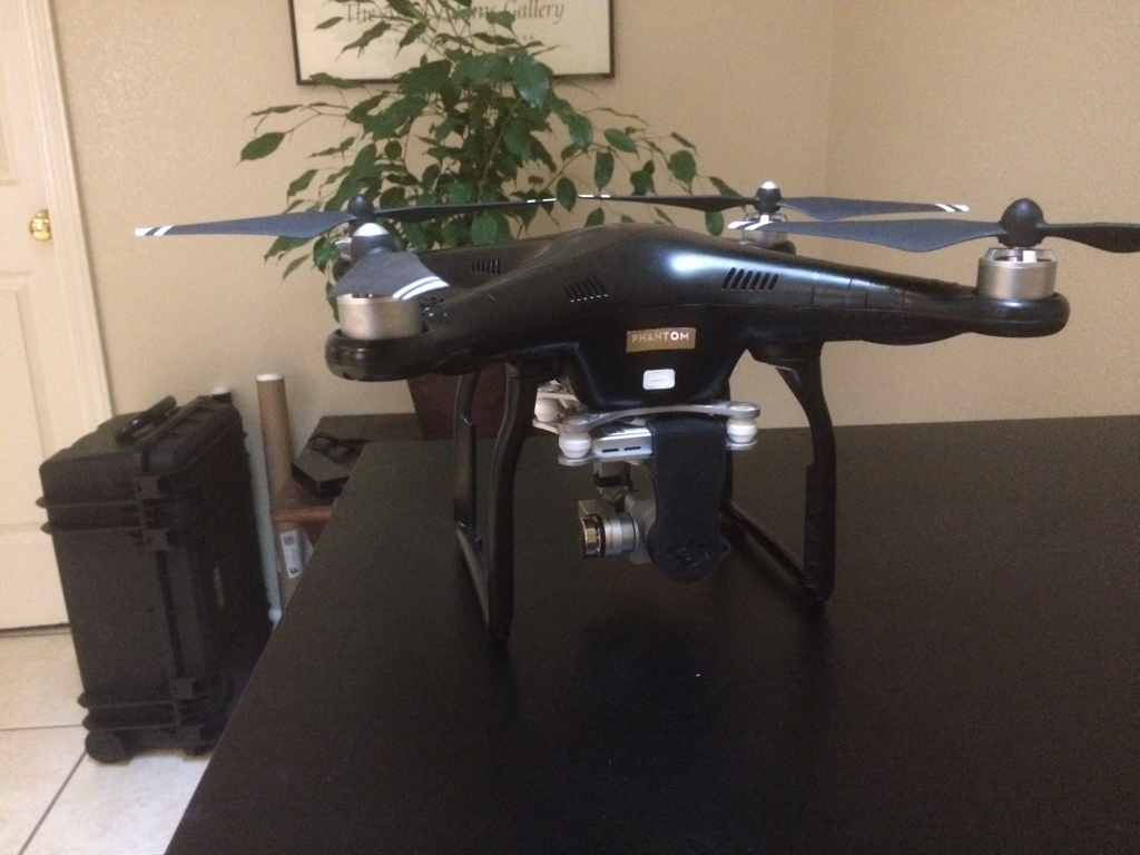

    Haha. Yeah I know. I'm the type that always has to mess with stuff. Decided to paint it too. Turned out pretty good. Just waiting for my storm trooper silhouette sticker to finish the top!
    Also gonna add white strips on the front arms

    I used the krylon fusion matte black.
    I could have spent more time on it but it turned out pretty nice.
    To be honest. *dont cringe*
    I removed the camera and gimble. I removed the vision sensor on the bottom and that's about it.
    I split the top and bottom and painted separately.
    Top was no problem and the bottom all I did was tape off the wires for the vision sensor, camera and motors.
    I just put the bottom section with the electronics facing down on a cardboard box and sprayed away. There was a little overspray on the circuit board but it was all on the component side so I wasn't too worried. I'm sure I could have taken a lot more care to protect stuff but I was more concerned with not getting it back together than a little overspray! All in all it looks really good and still flys with no issues.
    Hardest part was the 4 pins that come off the circuit board for the vision sensor. Other than that it was about 24 or so screws and splitting the top and bottom was a pain cause it feels like your gonna break it!
