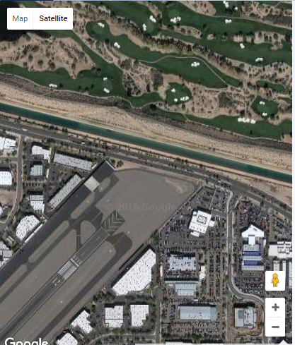

The problem, well I guess it's a good thing, is that since it's in a no-fly zone, the phantom can't even fly. However, l learned from DJI today if you have the proper authorization to fly in an area such as this, they can grant an override and allow you to fly. However, they say things like waypoint flying "may" be disabled so plan on flying manually, which is fine.
Here is what i'm talking about:
Can you tell us what airport this is? The FAA has been publishing maps that provide some assistance to pilots in filling out waiver requests. They give the altitudes around an airport that would likely be approved. However, judging by the map you posted, this is so close, I would be very surprised if the FAA approved this, especially if this is the airports only runway.
