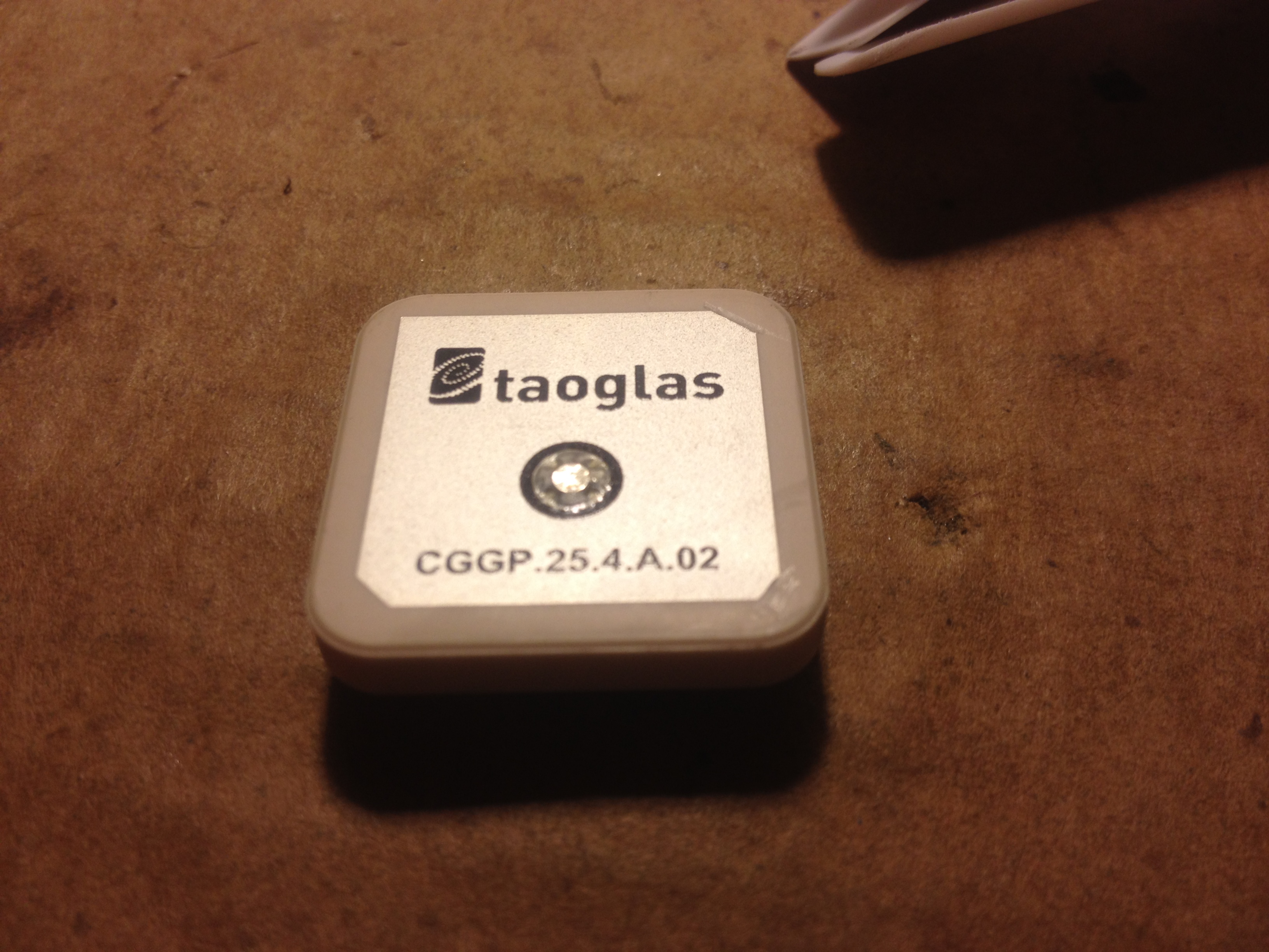

    Depending how hard and how you crashed, open phantom, under the top ( the GPS unit is located ) remove the GPS unit, inspect CERAMIC antenna , as they like to shatter in a decent crash. Might also require IMU calibration ( advanced preferably ), and after do a fresh compass calibration.

    Ps the ceramic antenna is super easy to replace with minimal soldering skills and $8, buy the 4mm antenna, not stock 2mm, you'll get s stronger signal, i can supply part number here:
    ( part number on bottom of antenna )
    Watch YouTube on correct way to open your phantom ( do not remove motor screws ) not that it matters, but you don't need to. Please let us know if we can help out more, and keep us updated!
