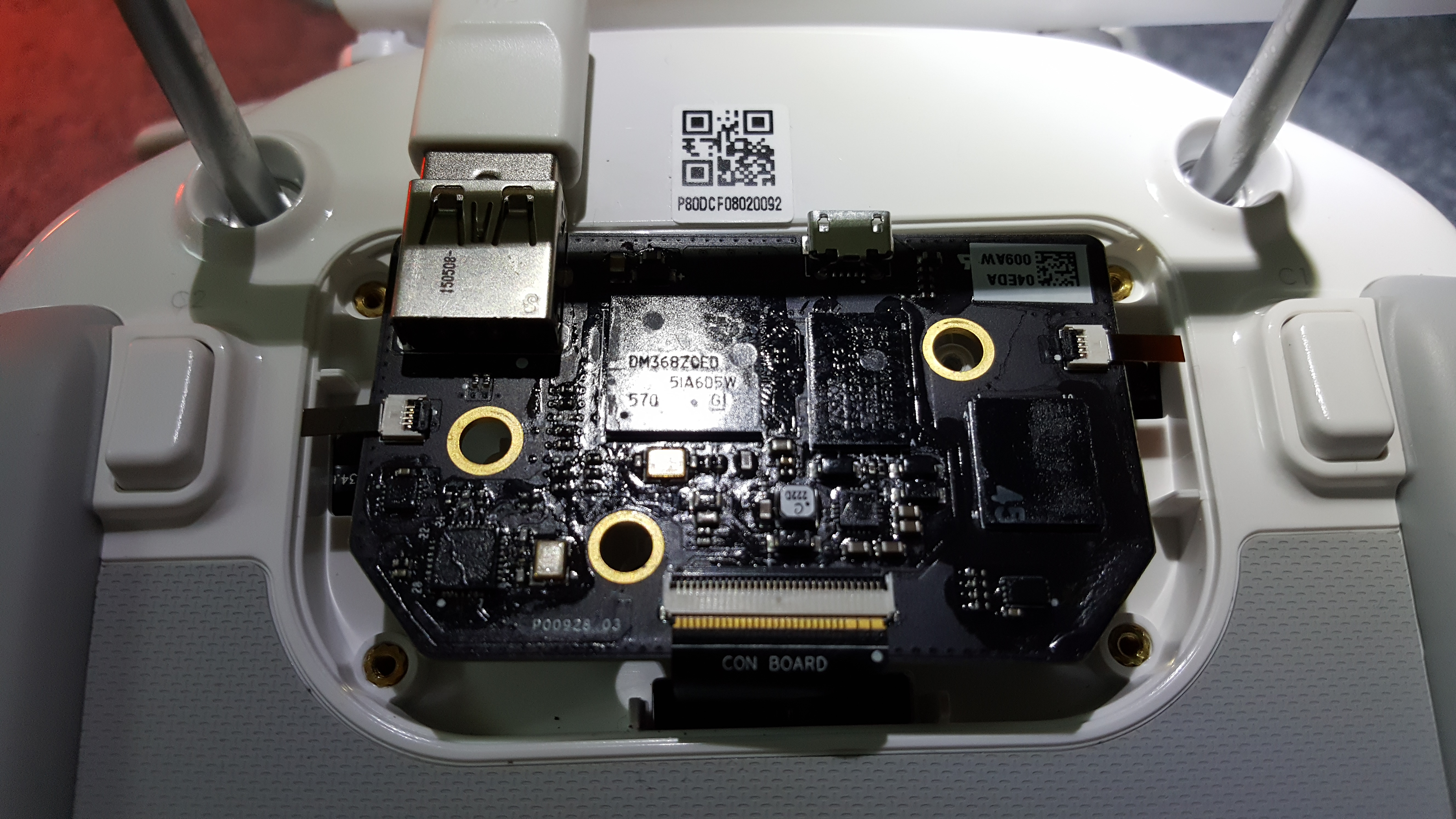

DJI has a Help Video showing how to remove and replace the circuit board, in case one wished to upgrade to HDMI output. I removed the circuit board and reinstalled it thinking that perhaps a cable could be loose or not well connected. NO LUCK.

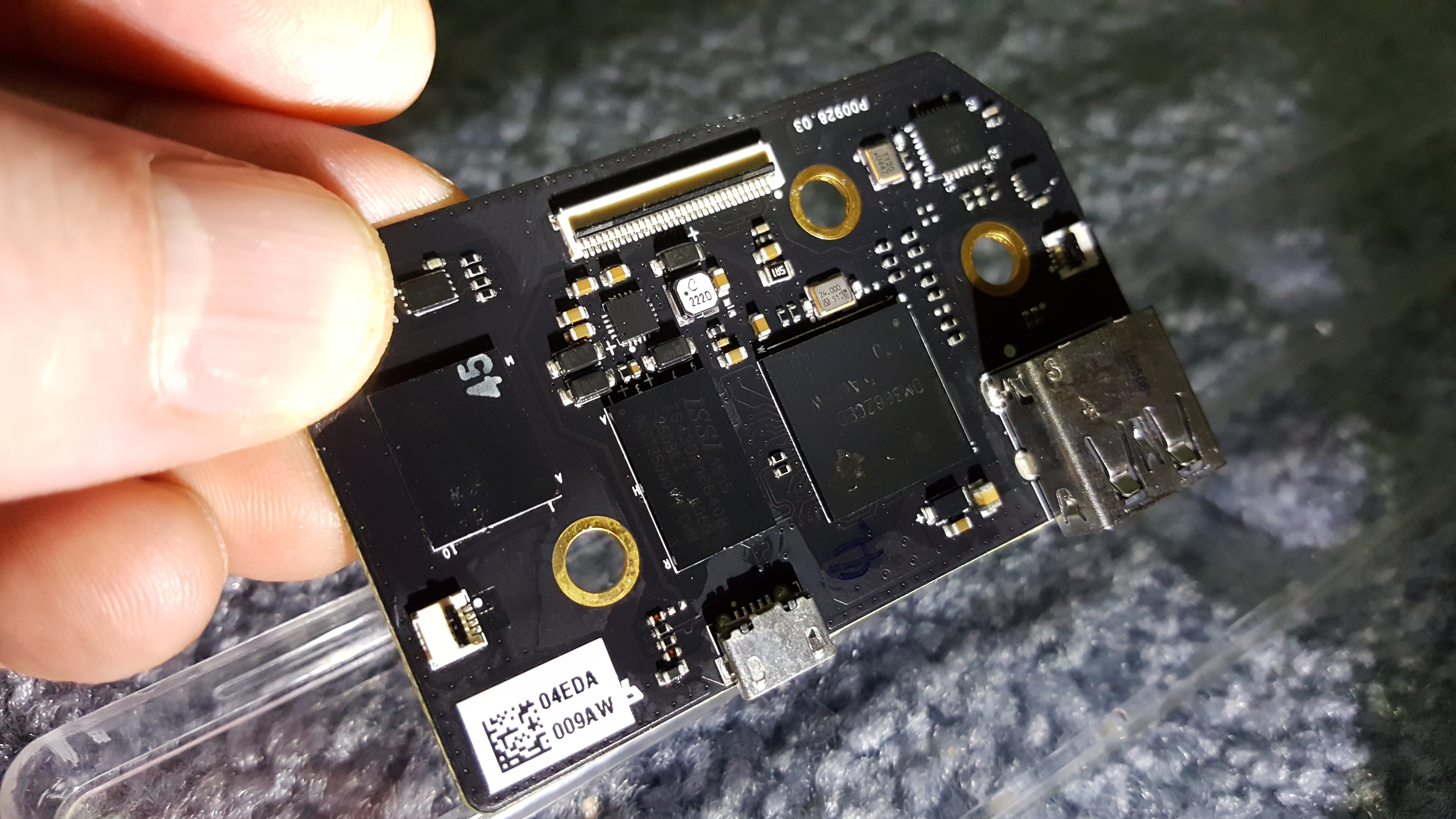

View attachment 57529 View attachment 57530

I just wanted to come back and add that i replaced the usb module with the hdmi module and I am in the air! The latest fw seems to have fried the usb port. Once I had the hdmi module on, its usb was working fine. RC had failed the upgrade and was not updating from a usb stick so I (reluctantly) updated from the Go app (which DJI has updated twice since this issue started, btw) and just like that, green lights.

So, I pulled my upgraded USB/HDMI board on the back of the remote. Viola! USB connects immediately. Something just went bad on the board. No to order a new board from DJI. I'll tell the how much I appreciate paying twice.
