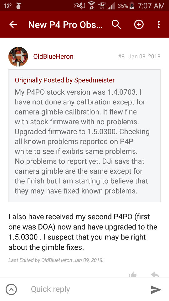

My P4PO stock version was 1.4.0703. I have not done any calibration except for camera gimble calibration. It flew fine with stock firmware with no problems. Upgraded firmware to 1.5.0300. Checking all known problems reported on P4P white to see if exibits same problems. No problems to report yet. DJi says that camera gimble are the same except for the finish but I am starting to believe that they may have fixed known problems.
I also have received my second P4PO (first one was DOA) now and have upgraded to the 1.5.0300 . I suspect that you may be right about the gimble fixes.
