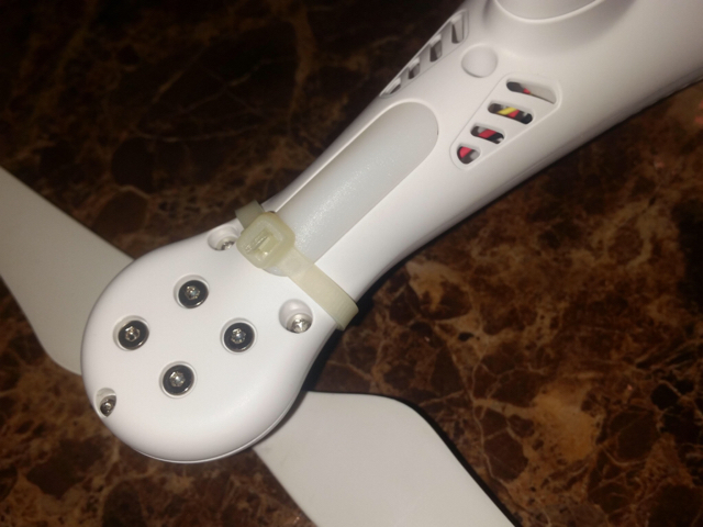

    Zip tie the arms

    What do you mean?

    A lot of people are having issues with the arms cracking at the 2 bolts closer to the zip ties in the attached picture. I'm on my second phantom and did this right out of the box.
    So far (knock on wood) no signs of any cracking with about 50 flights.
    I know it looks crappy but it works.

    Are these cracking from crashes or just from flight stress?
