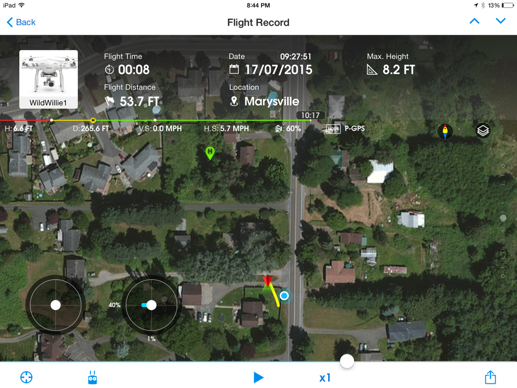

  13. Lone-Rider
    Jul 16, 2015
    18
    47
    No real toilet bowl type circling, just pretty much autonomous operation with no response to the controls. Battery level 60%.
    Here is a screen shot after take off and before crash if that helps anyone... ImageUploadedByPhantomPilots1437450456.165691.jpg
  14. Michael Collins
    Jul 27, 2015
    55
    12
    Something very similar just happened today to my friends new P3 in France. Almost identical situation except he landed it in different area of his property and the. Removed it to another. The drone took off right through an olive tree and tore up some blades . Not good at all. I will try and find his flight logs
