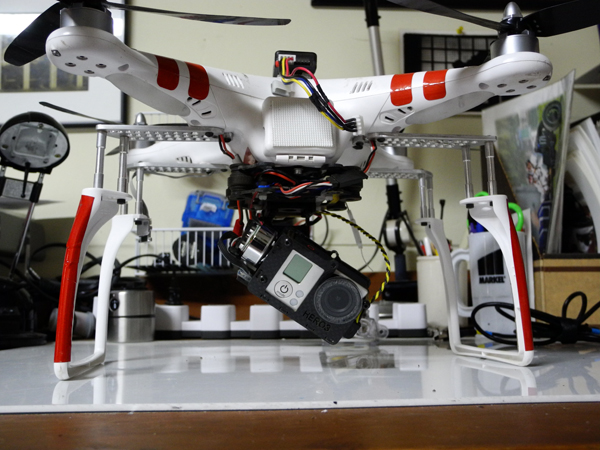

  9. DaveT1
    Mar 3, 2013
    47
    Here's what I did for a taller wider stance. I first bought a kit from China the broaden and heightened the landing gear. The risers were great, but the stance was still too narrow (I was trying to shoot straight down and not get the landing gear in the frame at wide angle setting). I made the extensions from 1/8" x 1" aluminum flat stock and a whole lot of drilling... The compass mount was made from a small piece of aluminum 1/16" x 1/2 angle stock. Note of caution: I mounted the compass to the leg with the steel bolt that came with the landing leg extensions. It was just enough steel to throw off the compass. I replaced all of the steel bolts with 3mm aluminum bolts and problem was solved. The whole landing leg additions weigh about 50 grams.
    I had the same tipping problem when I first started flying and found that I was pulling both levers down when landing a reverse of take off. That was causing the Phantom to want to backwards, tipping over. Just pulling down on the throttle shut the copter down without tip over.
