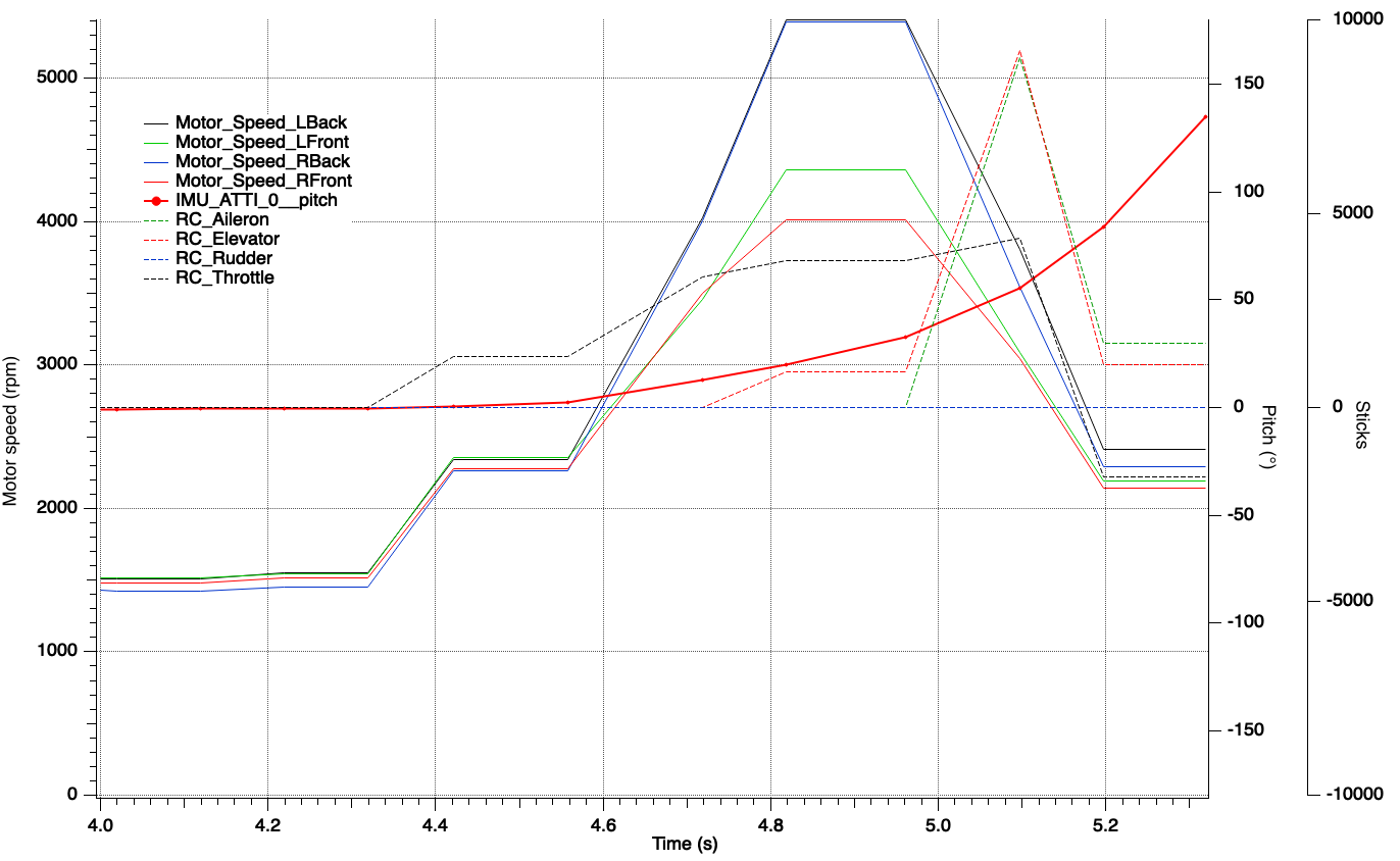

hi all i had written about a mishap i had and my p4p went up then immediately flipped and hit the board walk props first i found the txt file from the flight log but not quite sure how to post it so i can get one of you guys to take a look at it for me and see what could have happened, i know if someone wouldnt mind helping me get it to where it can be checked and take a look at it. thanks in advance. not sure this is the correct one the one where it crashed im not seeing i think this is the one where i flew right after the crash

That's the log of a one-minute flight at 10:56 am on December 5, that stops abruptly. Does it look like the correct flight?
i only made 2 flights the first was the one that damaged my p4p but it wasn't even a minute ,i dont think, this is the only one showing for that day. the short one is where it went up about 2 feet above the handrail i flew from and suddenly did a back flip and seemed to have accelerated and hit almost flat on all 4 props. right after it happened , i was freaked out ,, the battery had came out but i looked at it and just noticed the props were damaged do i changed props thinking that as all that was wrong and maybe i needed to calibrate my gimbal, so i took off again this time from on the boardwalk ground level , got it up to 6 or 8 feet and it hovered good , i tried to straighten the camera in the settings and noticed it was hanging at a angle so i landed right away and shut it down. so im thinking this may be the second flight i dont see any other flight on this day. Now when i look at the mcdat flight records i see 4 things in there from that same morning.

FLY234 was the flight in question. You attempted to takeoff manually and applied the throttle way too gently - that's a common cause of tip over on launch. You really need to apply full throttle, at least briefly, to get the aircraft off the ground.

Thanks so much for taking the time to check it out for me , i dont know what i did , i been taking off the same way with all of my drones since the phantom 2 vision. I been flying since 2015. I guess maybe i didnt notice i had not throttled up fast enough i normally hit it hard til its up about 10 feet. I had a total of i think 3 start ups that morning first was acting really squirrly so i landed and rebooted every thing, second was the one that i got the damage it seemed to have went up really fast and flipped backwards and hit the ground hard and the battery came out. the third was after the crash it was a short one also as i noticed my camera was not sitting right but still had video feed and all the telemetry looked good.
