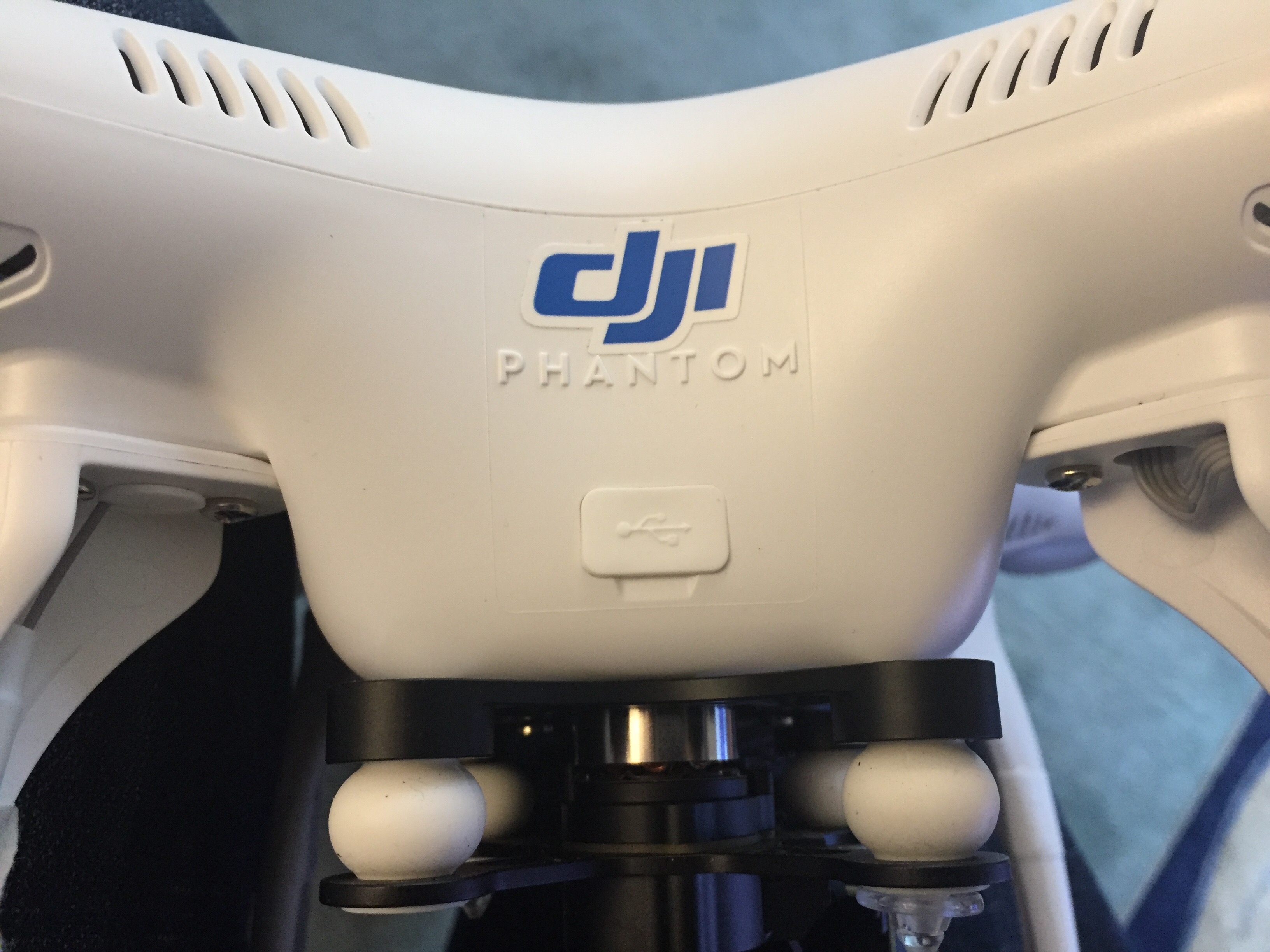

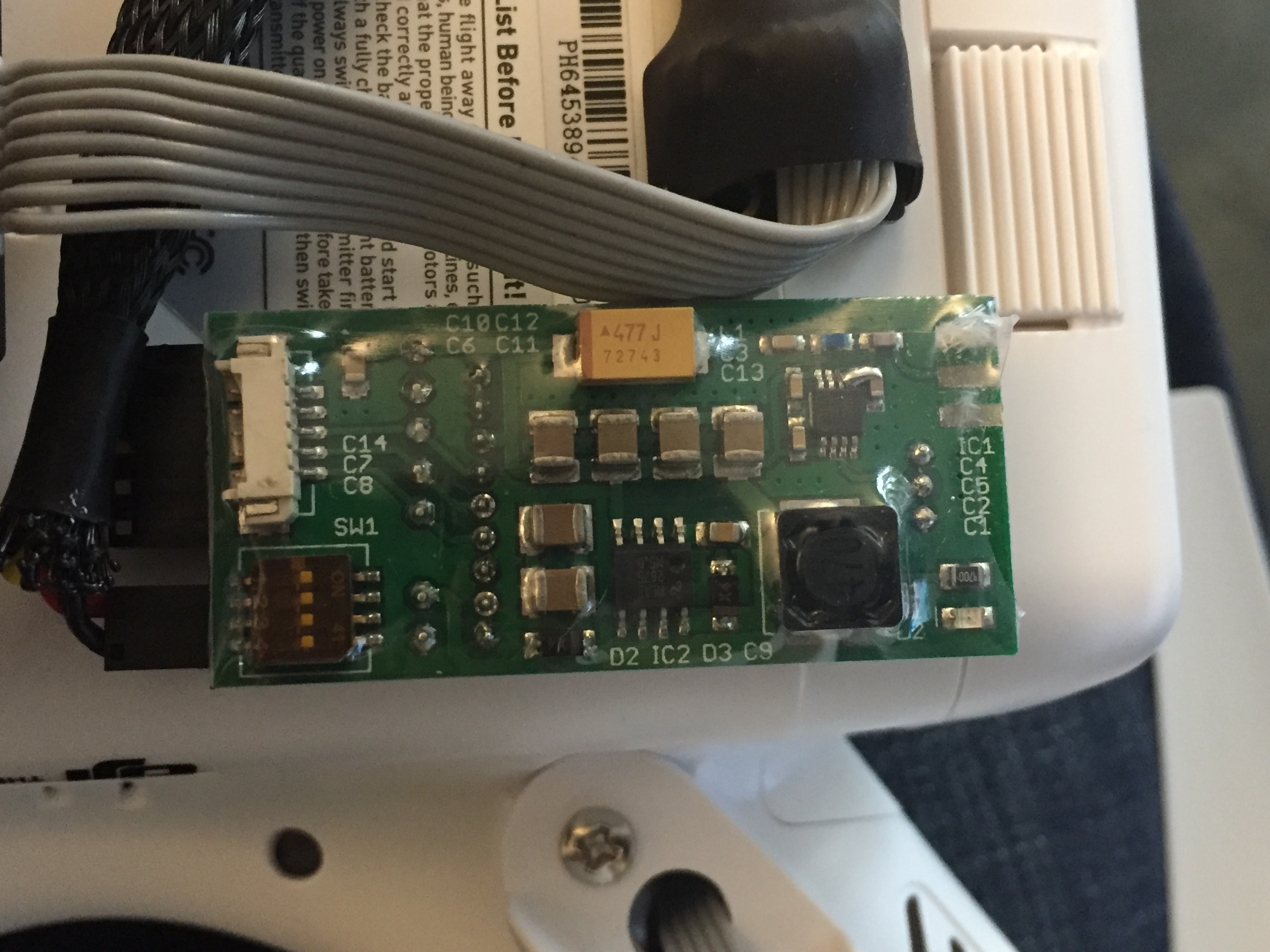

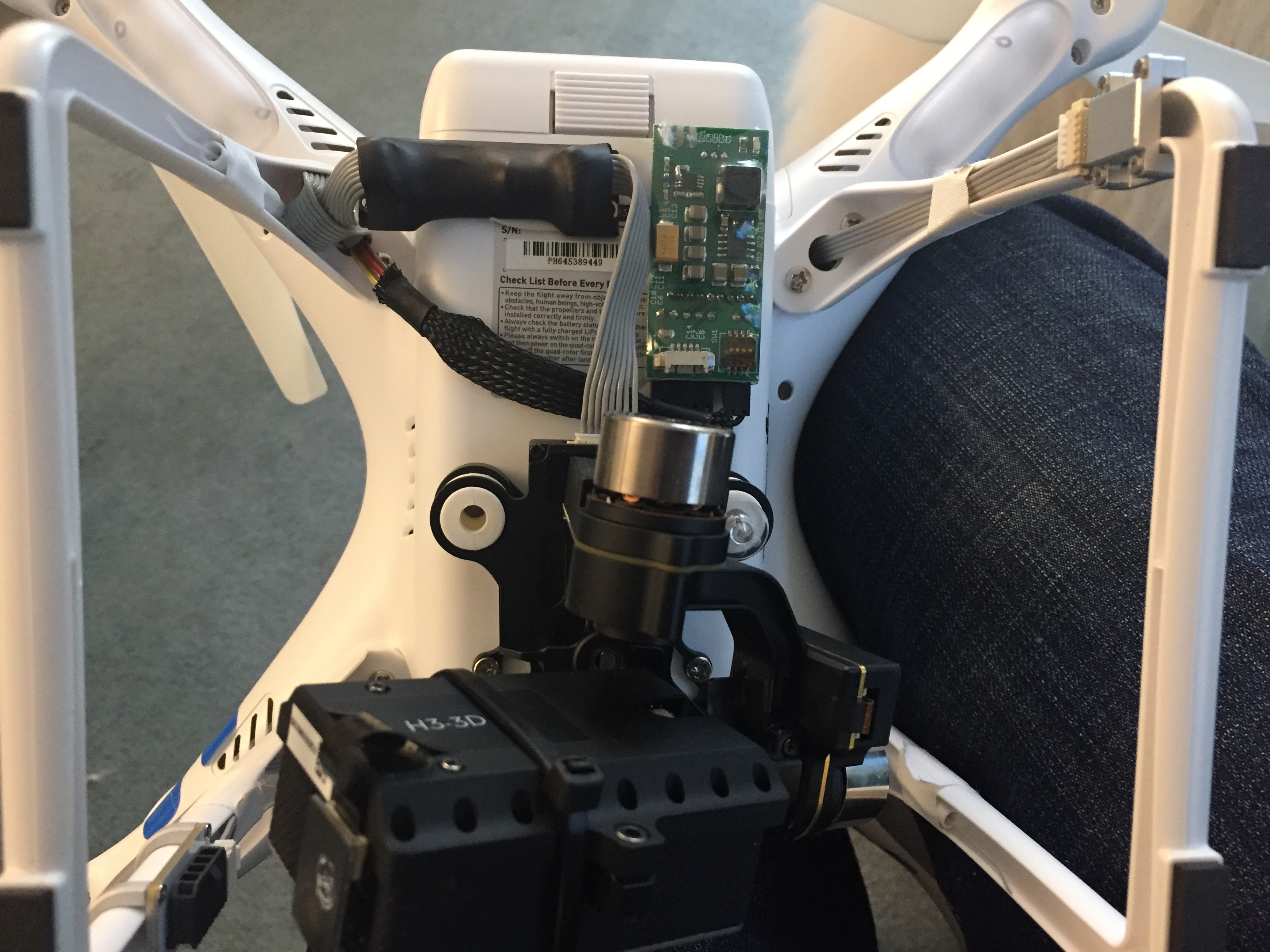

My dad has this Phantom 2 and he said an antenna or something broke off of the circuit board on the bottom. I need help identifying the part he needs to replace. I have a Phantom 3 so I am not familiar with this model.
My dad has this Phantom 2 and he said an antenna or something broke off of the circuit board on the bottom. I need help identifying the part he needs to replace. I have a Phantom 3 so I am not familiar with this model. View attachment 84212View attachment 84213View attachment 84214
The RF antenna connector was broken off the transmitter and unless you have the connector you will need to replace the Immersion video TX. That looks like an Immersion 600 mw TX and you'll also need an antenna.
