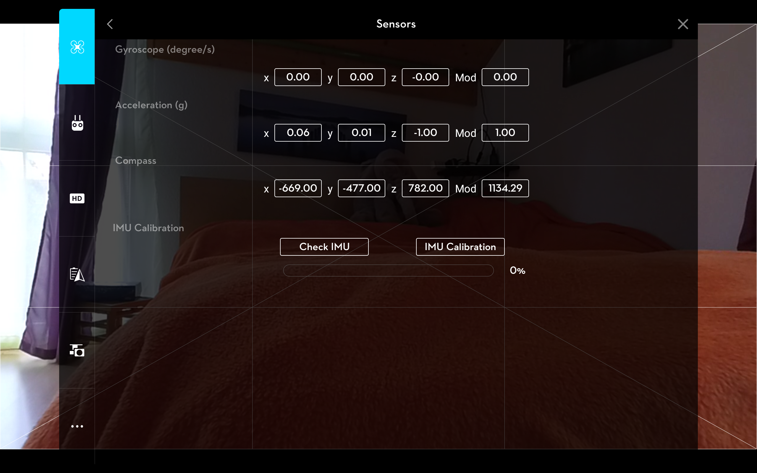

    Good you were able to recover it. Same happened to me 2 times. First time I didn't know the ATTI tip, and it finished up-side down.
    If there is too much metallic stuff around when you calibrate the P3 compass, including bellow ground (pipes, reinforced concrete, ...), maybe the P3 accept the calibration and to fly, but when you go up in the air, it is no more affected by all these metallic parts and the calibration then becomes invalid and it starts to drift away.
    You can check in the sensor data what is the MOD value for the compass. It should be around 1500. Also the gyroscope MOD should be 0.00 and acceleration MOD 1.00. For these 2 it is IMU calibration at home that would be required if not ok.
    Having a look on these values is good to have in your pre-flight check list.
    Bellow is a bad sample at my home, so the compass MOD is not good.
    Best is to have a good calibration of compass in a really remote area with nothing around 100 meters and then to stick to it in general. If you change your flight place for some long distance, there could be change in the magnetic deviation of magnetic North and that would require a recalibration. Also firmware upgrades usually are followed by recalibration, just to be on safe side.
    Sometimes the P3 indicate a compass error at start due to some metalic part in the soil or in the environment. So moving it a little usually do the trick. When it is up, it again get better condition.
    Another think to check is the level of solar activity that can affect the bird. You can check at UAV Weather Forecast the Kp level for a given place and date that could indicate period where it is better not to fly. There are also apps for that.
