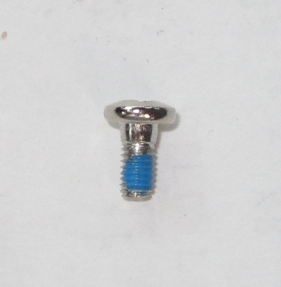

    There's nothing wrong with using Loctite on the screws but it must be used in a small enough quantity to not spread beyond the metallic inserts. A drop can be literally too much, it works best to just allow the Loctite to run into a couple of threads in the middle of the screw and then allow it to set up before sending the screw home.
    BTW this is the same method used on the factory supplied shell screws.
    [​IMG]
    Wayne

    Actually I used a very tiny amount of Locktite, used a tooth-pick to put a tiny drop on the screws. Didn't let it cure before sending the stews back in though. Anyway, apparently that still was to much. But luckily the fix worked very well. (actually I crashed my P2V afterwards, nothing to do with the fix ;) , and the fixed parts held out quite well).
